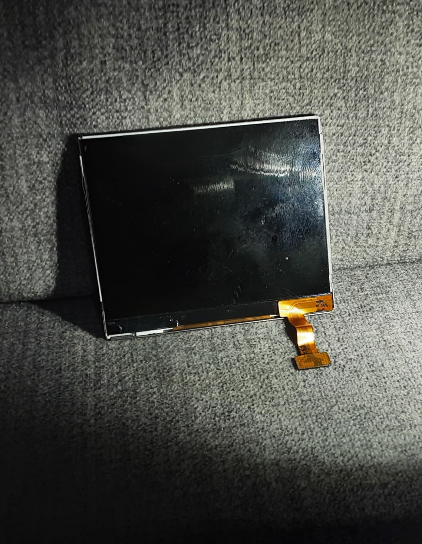

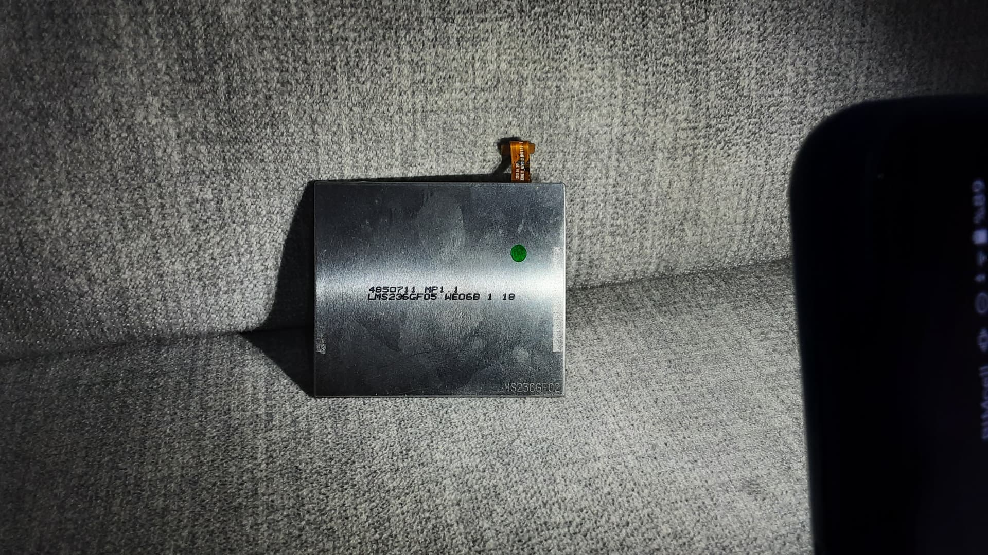

Please identify this Nokia X2-01 LCD's driver,pinout
Hi, its me again... anyways, i have a Nokia X2-01 lcd laying around and i dont remember where it came from(probably came from a phone in scrapyard i guess) and i liked the nokia color lcd project in instructables and i was wondering if i could make the same type of thing, the LCD's part number is LMS236GF05, can someone identify the Driver and the pinout please
Edit: i wasnt able to find anything abıut the driver or datasheet of this lcd (serched it in other langauges too)
i will attach some photos
Thanks!
Yeah so funny, i couldnt find any thing about the driver of this lcd (searched it in other languages too)(and i am not so good at identifying/using scrap components)
Probably because the important information is patented or proprietary.
Find the sales branch of the manufacturer and ask for a sample (free). Find the support branch and ask for documentation for the free sample. Careful... I tried buying one "part" this way and the company almost billed me for 10,000 units (their minimum "1" size). They just do not have the time to deal with individual sales.
Ok, when i search it on the internet i am finding a lot of sellers (without the datahseet) and the economy is so bad in my country(inflation increased so hard) these type of lcd's go from 130₺ up to 30,000₺ so maybe i cant buy them from the sellers directly and i dont even know if they ship it to Turkiye , it is probably SPI and can be the driver same as the other Nokia LCD's? In 2021 i had a lcd(a little bigger than this Nokia x2 lcd) and i connected it to a motherboard(ig it was navigation system etc.) It worked, thats why i think that this lcd has a counterpart with another lcd that has the same driver(this is a guess).
sterownik tego wyświetlacza to R61511 i dział z biblioteką MCUFRIEND_kbv.h
pinout display i schemat podłączenia z którego korzystałem do sprawdzenia wyświetlacza.
dziękuję bardzo!!!!!!!!Czy jest coś jeszcze, co powinienem wiedzieć? czy możesz mi też podać przykładowy kod i powiedzieć, jak udało ci się go znaleźć i jaka jest biblioteka sterowników, Jaki jest rozkład pinów złącza elastycznego wyświetlacza LCD i jakiego typu złącza używa?
Also, thanks for your help
wyświetlacz mam podłączony przez bezpośrednie przylutowanie cienkich przewodów od goldpin do punktów lutowniczych w miejscu gdzie było oryginalne złącze .
jak tylko znajdę chwile czasu to udostępnię schemat i kod arduino . Ja używałem własnego arduino z atmega 128 ale mogę to zrobić dla UNO.
