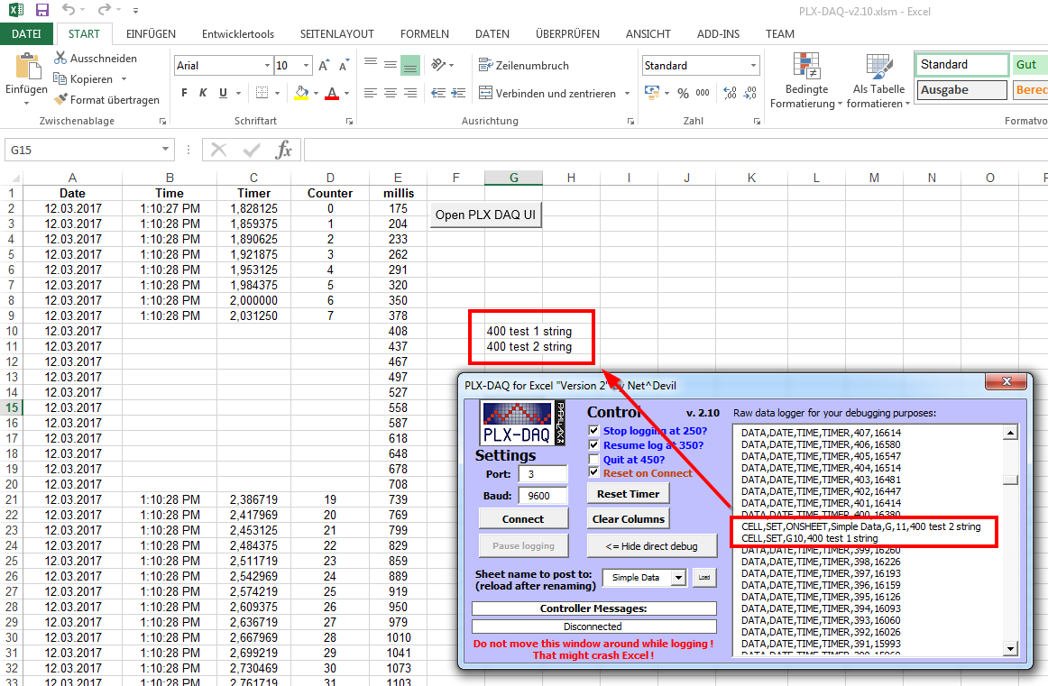

**This version is already outdated !! Link to always most recent version of PLX DAQ v2 here:**
**==\> [PLX-DAQ version 2 - now with 64 bit support! (and further new features) - Interfacing w/ Software on the Computer - Arduino Forum](https://forum.arduino.cc/index.php?topic=437398.msg3013761#msg3013761) \<==**
Anyways I created a new version today and even created a Beginner Guide for people to get a better understanding of how PLX DAQ v2 works and how they can start using it. It also lists all commands that are available for Arduino thus even the more experienced users might benefit from that guide 🙂
What's new in "Version 2.10" aka Change log:
- I wrote a 9 pages long **Beginners Guide to PLX DAQ v2** for newbies to get started with the tool.
- **Extended the CELL,SET command** to be able to set cells on other sheets as well (after CELL,GET with version 2.9 😉 )
Syntax is Serial.println("CELL,SET,ONSHEET,SheetName,Column,Row,Value"); ==\> e.g., Serial.println("CELL,SET,ONSHEET,Simple Data,E,4,My Test String");
- **Modified CLEARSHEET** command. It will now clear data starting at row 1. So it will clear the whole sheet as its name suggests. To clear only the data I **added a new command CLEARDATA**. I think the names are less ambiguous now 😉
- Updated the default sketch to include the new commands
Backlog for next version(s):
- find a solution for Excel crashing when moving the window around while logging. Priority: low ; Workaround: don't move window while logging ; Status: clueless...
- solve get cell / set cell mix up reported by jl1cny [here](http://forum.arduino.cc/index.php?topic=437398.msg3126106#msg3126106). Priority: medium; Workaround: use baud rates smaller 25.000; Status: in contact with Sam SASv directly via email to identify issue. Best guess is an issue in Arduino code with Serial.ParseInt not getting values out of buffer correctly
- Double check if both issues above existed in PLX DAQ v1 as well. In case yes =\> we are screwed
Image-Link: [http://www.freebie-base.de/Pics/PLX\_DAQ\_v2.10.png](http://www.freebie-base.de/Pics/PLX_DAQ_v2.10.png)
(hosted on my server, no traffic hijack)

Hi NetDevil
The PLX-DAQ-Cellvalue-Manipulator-Test-v4 is impressive. And unfortunately, what had worked best in my tests, putting delays before GET and SET commands, did not work. (I had also tried flushes previously with mixed results, worse than adding the delays). So, I hope your much more capable hands will come up with a solution.
CORRECTION: See post below
And thanks for the new SET command.
<div class="post-metadata">
**Author:** ![anon17055972](https://avatars.discourse-cdn.com/v4/letter/a/3d9bf3/32.png) [@anon17055972](https://forum.arduino.cc/u/anon17055972)\
**Post date:** [March 14, 2017, 4:26am UTC](https://forum.arduino.cc/t/plx-daq-version-2-now-with-64-bit-support-and-further-new-features/420628/68 "2017-03-14T04:26:03Z")
</div>
Hi again NetDevil
I spoke too soon. It seems the more involved the test the longer the delays needed before GET and SET commands.
I used your test with the flags set:

Hi SASv,
thanks once more for the intensive testing you have done 🙂 I implemented your suggestion into the cellvalue manipulator (500ms delay for every GET and SET) and it did indeed do the trick for higher baud rates (I had some successful test runs with 60.000 baud 🙂 ).
I am still kind of clueless why it is working this way though. Having a delay before GET/SET shouldn't hamper the read later on .... I mean, why pause, then send a GET, then read directly and it is ok? I would understand if we need a delay between the GET and the read to get the buffer free. Or use a flush on Arduino side or Excel side before the read / send ... crazy ....
Its sad to see such large delays are needed since they really slow down the overall performance. However using "only" standard DATA,Value1,Value2,Value3 commands never produced any issues even at highest baud rates so far and I guess thats the most important part.
I will add a note to my Beginners Guide to be careful with CELL,GET and CELL,SET and using at least some delays prio to it (between 100 ms and 500 ms) thus everyone should at least be aware of the issue. I need to update that guide anyways to format chapter headings and include a table of contents.
That adding up of needed delays based on the number of prio GETs/SETs is crazy and confusing as well. One could write a bachelor thesis I guess in order to figure out what the exact needed value for your final GET/SET must be based on how many prior GETs/SETs were used with which delay 😃
