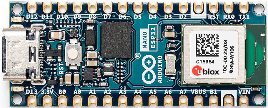

Hi @ap15182002 .
Are you using an Arduino Nano ESP32 board?:
ABX00092_00.default_1000x750.jpg by Arduino - CC BY-SA 4.0 (crop background)
I ask because your sketch appears to be for use with a board that has a camera (e.g., the ESP32-CAM).
When you say "disconnect", do you mean that the board stops producing a serial port?
If so, this is probably caused by a bug in either the "TFT_eSPI " library or version >2.0.14 of the "Arduino ESP32 Boards " / "esp32 " boards platform:
