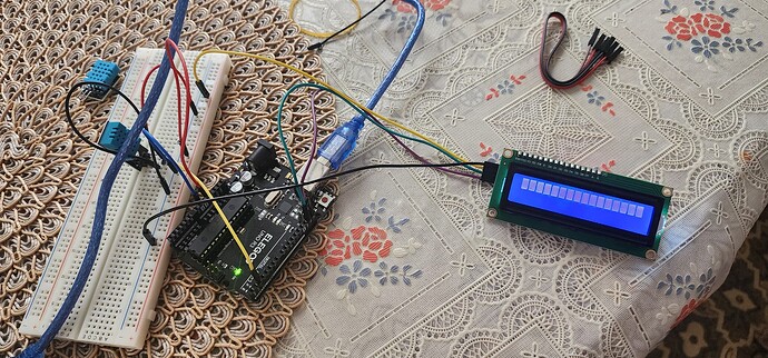

I try to upload the code but its giving me error no connection established
 ![20240503_110644](https://europe1.discourse-cdn.com/arduino/original/4X/a/9/f/a9fa851206bf410371762099dc9c91be9bd74b87.jpeg)
 ![20240503_110650](https://europe1.discourse-cdn.com/arduino/original/4X/d/b/1/db1cddccb934b28e2e4ff7ba226a0fc6b33aba94.jpeg)
 ![20240503_110656](https://europe1.discourse-cdn.com/arduino/original/4X/3/d/4/3d47ec94f821169bf366a87c49feaf1e79d03792.jpeg)

Now its working but not showing correct temp amd humidity how to fix that
 ![20240503_112342](https://europe1.discourse-cdn.com/arduino/original/4X/e/5/c/e5cbb79f7881d5586cbfdd2919e9ecc269587ea7.jpeg)

> [@rtariq895](#):
> how to fix that
I'm going to guess that you connected the DHT11 wrong. Check the pinout; I think you've mirrored it (switched GND and Vcc), but it's hard to tell with the relevant connections hiding behind a USB cable:
 ![image](https://europe1.discourse-cdn.com/arduino/original/4X/f/a/a/faacc5100acbee765b321a086225ed84dc9fb991.png)
Should be like this:
 ![image](https://europe1.discourse-cdn.com/arduino/original/4X/b/a/e/bae00e802df733e6bf5fff6b6cc6f97f595ec0c2.png)

Thank you so much
