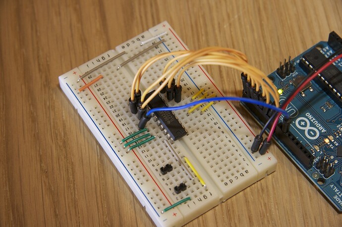

Hi! Thank you for answer. You are right, I can use digitalWrite() function, but as you can see on the page
> **[Arduino Function Generator (Part 3)](https://www.auctoris.co.uk/2012/04/13/arduino-function-generator-part-3/)**
> In my previous posts in this series I looked at a couple of ways to use an Arduino to generate analogue waveforms. In this third part I look at a much simpler, IC-based digital to analog (DAC) circ…
the author says that digitalWrite() function is very slow. So, if I need to set 8 pins, it means 8 calls to function digitalWrite(), which will significantly slow down the execution process.
Second, it is much more conveniant to control a bunch of pins, like 8 pins, 16, 24 or whatever number of pins in just one operation, like a call to PORTD.
It seems to me that there has to be a way to do it.
