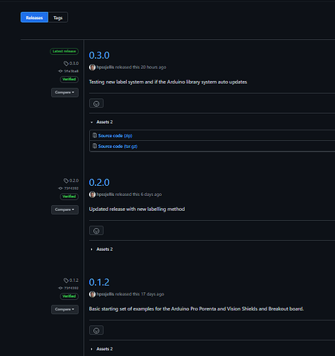

Can you suggest a link for information about setting user made libraries to update and show all releases using the official Arduino Library site? I know I am doing something wrong, but finding how to do it correct is difficult.
Anytime I Google "Arduino Libraries" I get info about Arduino Libraries. I have my Portenta Library (portenta-pro-community-solutions) working with the official library manager, but I can't figure out how to add new releases. On my github I make a new release and update my library.properties, but it never seems to get registered with the Library manager. Any suggestions?

Hi @jerteach. The problem is here:
https://github.com/hpssjellis/portenta-pro-community-solutions/blob/0.3.0/library.properties#L2
version=0.2.0
When you did this:
you got the order backwards. The procedure should be:
  1. Increment the version value in library.properties.
  2. Create a release or tag.
The unit of the Library Manager index is Git tags. The indexer checks out the repository to each tagged state and then runs a validation process. Only if the validation is passed is the library release added to the index. One of those validation checks is whether the release version, as specified by the library.properties version value, is already in the index. So it checked out your 0.3.0 tag, but then saw that the version was specified as 0.2.0 and that there was already a 0.2.0 release of the library in the index.
It might be confusing because we often use version numbers for tag names, but the Library Manager indexer completely ignores the actual name of the tag. It could be named foobar for all the indexer cares. All metadata for the Library Manager index comes from the library.properties file.
So you have two options to distribute the latest version of your library:
  • Create a new release. Although not required by the indexer, since there is not yet a 0.3.0 version in the index, I would still recommend bumping the library.properties version value before making the release to avoid any confusion for the visitors to the repository when they discover that the version of the library tagged as 0.3.0 is not the same as the 0.3.0 release in Library Manager.
  • Redo the existing release. This is not considered best practices in repository management, since a release is intended to be an immutable point in the project's history, but you're the boss of your project and best able to evaluate whether it is problematic.
