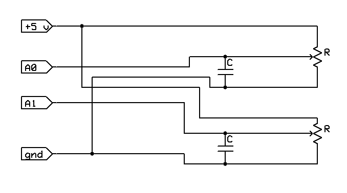

Potentiometer problems ok this is the deal I have two pot's one on A0 and one on A1.
All good but if I turn pot A0 it changes A1 same for A1 turn it pot A0 changes.
Well, I guess we should see your sketch and a good picture of your actual wiring.
There is one analog-to-digital converter in the ATmega chip, multiplexed between the analog inputs. It may need a short time to "settle" and stabilize. Try taking each reading twice, ignoring the 1st reading, or add a short delay between readings.

There 10 pots there reading as 5k each
potpin1 and potpin2 are both = 0
did you want A0 and A1 ?
Here the sch.
LarryD:
I see that set's the pins both to 0 LOL I was thinking it was just a variable and it is just pointing to the wrong one LOL.
"There 10 pots there reading as 5k each"
I don't understand the 10 pots. I thought it was two.
I don't see any problems other than what LarryD points out.
It is two 10 k pots but they read as there in parallel so there reading as 5 k but the change the reading on one it you move one.
Say one is at 3.3 k that changes it to 2.4 k

Can you read the center tap of the two post with a volt meter? How does it look as you turn the pot?
The pots being connected between ground and 5v, you should see the center tap voltage swing between ground and 5v (with about 2.5v half way). Does that look right?

It was the potpin2 = 0 I was thinking wrong it's a pointer to the pin your setting I though it was just a int and needed a starting val of 0 It works.
