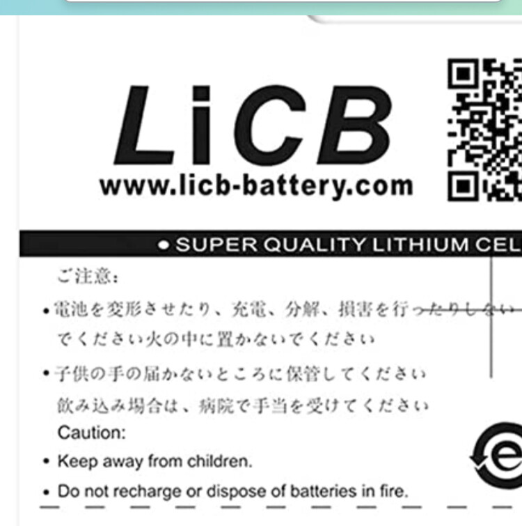

I just found these 3.7V 550mAh batteries:
1- With a voltage regulator from 3 to 5V, connecting it with this Arduino: https://www.amazon.com/-/es/gp/product/B08CN5YSQF/
It's going to work, right? (I am making a wearable and if I use the typical yellow 3.7v lipo battery it would be great).

Those batteries are not rechargeable.
It says those are 3V cells, not 3.7V cells.
Also, NOT rechargeable!
What sort of life do you think you will get out of a battery like this? Typically less than an hour in my experience.
As Grumpy_Mike said, the bad news is that while those batteries have a 550mAh rating, you won't get much life out of them the way you want to use them. They are rated at a maximum discharge of 10mA, so you would probably get 55 hours life at that point, but the intended use case is for very low current operation: typically 1mA or less.
