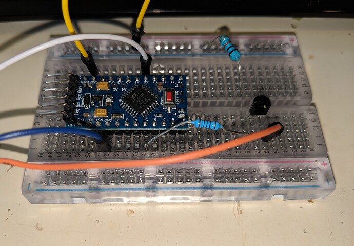

I am sorry, but your discussion is way beyond my understanding :slightly_frowning_face:
The only one I pretty much got was @wolframore
Can you please look at the board I attached and tell me if that was your intention or did I mess it up?
The orange/Blue/white are the Sensor Red/Black/White
