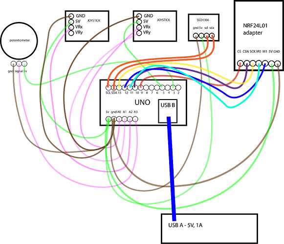

Please post a schematic diagram of the setup, showing how everything is powered.
The Uno 5V output cannot power a radio with a PA.

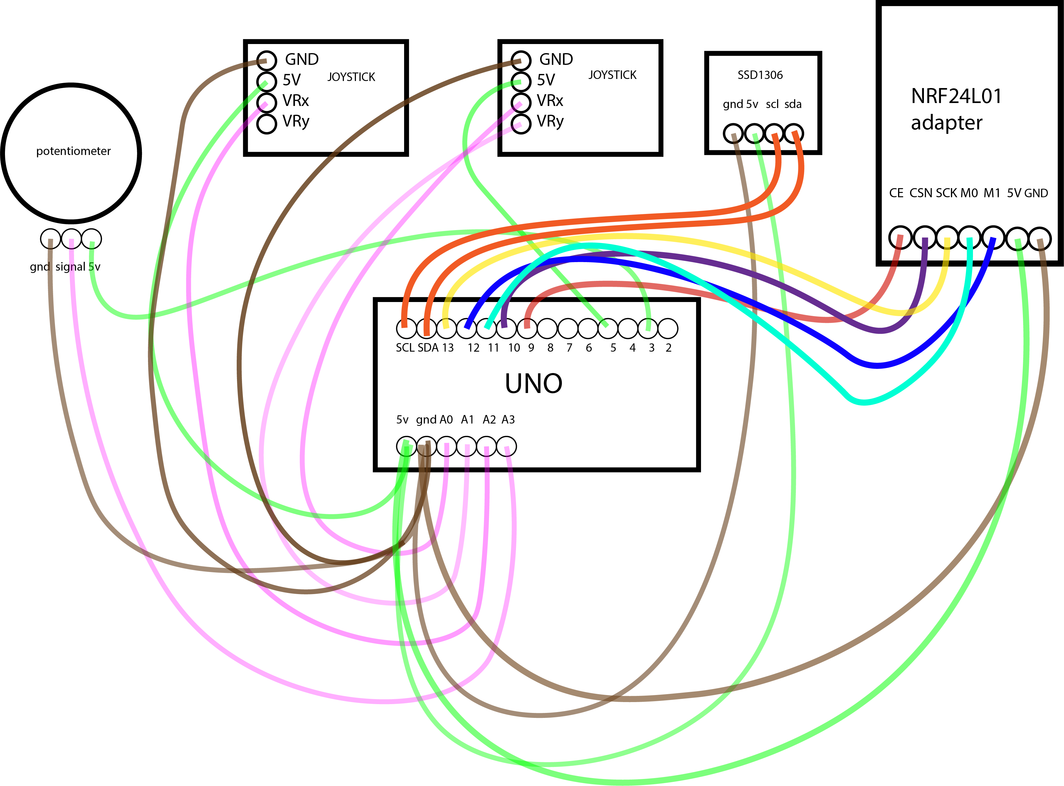

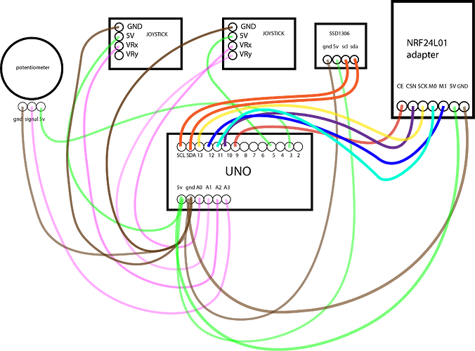

So i should just get an external power supply for radio so it doesnt put any load on arduino? (also sorry for rough schematic)
Please add that to your diagram, which shows no power supply.
I also have 1500 mAh 7.4v/30C LiPo battert with soldered DC jack connector. However after i plug it into arduino, theres no change from powerbank. Still wont transmit.
If neither of those power options work with the high power setting, but the radio works on lower power settings with both, then the limitations of the Arduino voltage regulator is not the problem.
Something else is probably wrong.

Theres adapter that makes sure its not 5v. Also i wouldnt like to disassemble those modules as i know i lack skill and tools to operate on electronic this small.
The voltage regulator on that adapter might not be able to supply the required current, at full power.
