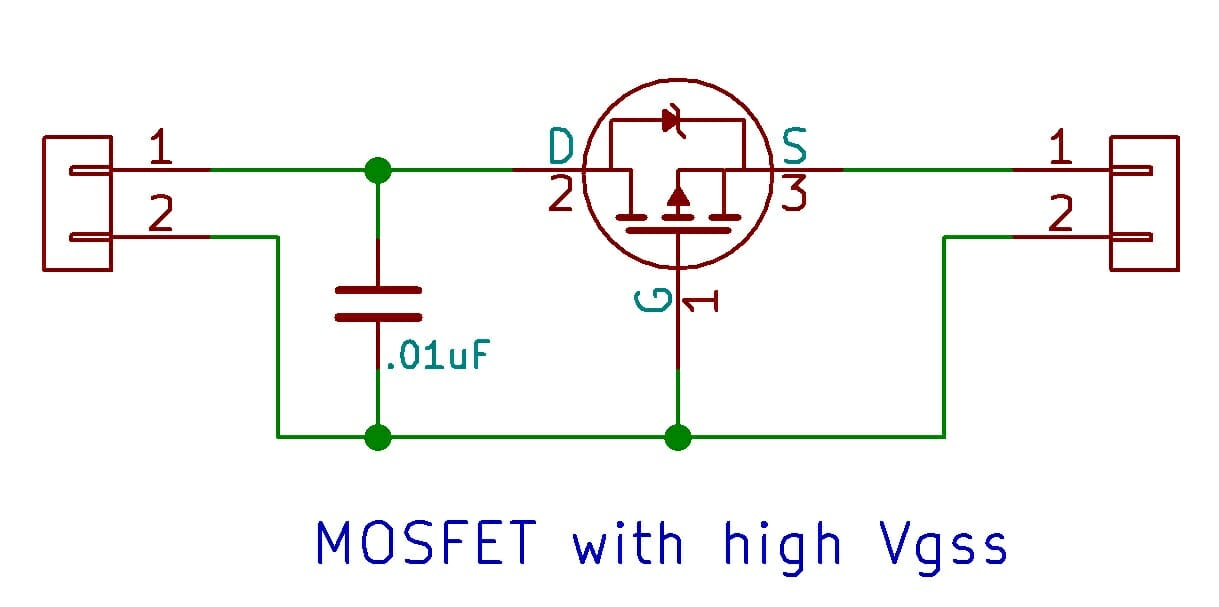

You can Reversed Polarity protection With MOSFET
