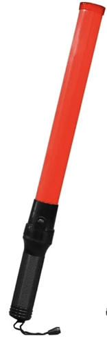

Third project here, learning a lot about power supplies, regulators. This is a fun project to build on a normal simple traffic wand
I want to add features like:
  1. Smooth LED line instead of dotted,
  2. Program patterns and colors to be set with a switch.
I'm thinking of the following hardware:
  1. 1m of COB LED individual address with WS2812b: https://a.aliexpress.com/_mtQdfiR
    a. 18w at 5V over 240 LEDs. (3.7A!) I'm guessing I'll need to cut that back a bit.
  2. Xaio Esp32-C6 with built in charging,
  3. Li-ion 18650 cells,
  4. Using an old wand for the structure.
Here are some requirements:
  1. Programmable
  2. Battery endurance approx 3 hours
  3. USB C port for charging, software updates,
  4. Batteries must fit in the handle. There's room for 2 18650s
  5. Maximum efficiency due to the lack of battery space and high number of LEDs.
The point I'm at in design is how to power both the esp32 and the LED strip.
I've read about linear vs switched, LM317, AMS1117, L78XX, HT7533, LM1578a, and lastly the
XL6009
Currently I'm thinking of boosting the batteries in parallel to 5V for the LEDs, and regulating for the esp32. Does that give more mAh than bucking a 2S?
Is there a generally preferred approach to this scenario?

Do NOT under any circumstances put 18650 Lithium cells in parallel. They stand a very high risk of exploding or catching fire.
Do your math on the LEDs power requirements.
If the batteries are 2x3.7Vx2500mAh then you have before conversion losses 18,500mWh or 18.5Wh which means maybe 1 hr of use. Since LiPo or LiIon is for all practical purposes the most energy dense batteries available to us this means at least the equivalent of 6 18650 are needed.
Another option is a larger (see pic) LiPoly pack like RC modellers use carried on your body, either belt or back pack and a cable connects them to the wand.
I am attaching 2 pics of a 57.72 Wh battery, the 2nd shows dimensions and a link to the charger you need. https://www.skyrc.com/ I think the S100neo would be a good fit. That charger CAN do parallel, that is what the small wires (JST/XH) are for, it's called balanced charging.

Thanks! I was doubtful about my calculations.
Yup, I need to accept less LED density.
