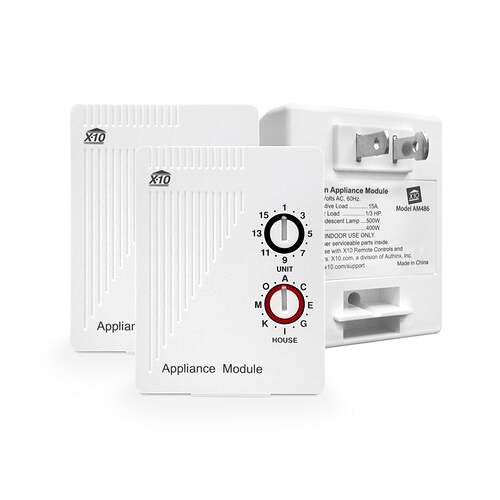

@thatkookooguy, you can also use an X-10 power switch. http://www.x10.com/x10-home-automation.html
There is more than one maker.
