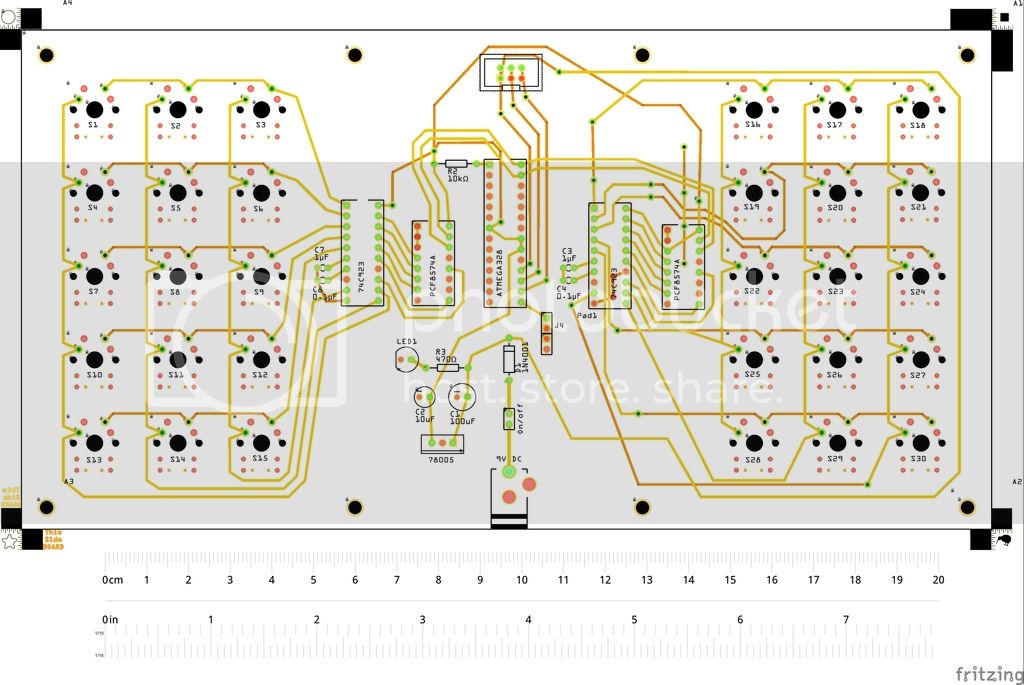

I'm building a darts scoreboard. The whole project has three separate PCBs (not made them yet):
  • The keypad with power supply feeding in via a DC barrel jack, which I originally had planned to supply with 9V. Currently this connects to a 1N4001, which connects to 100uF electrolytic capacitor, this connects to Vin of LM7805, which connects to ground and Vout connects to 10uF electrolytic capacitor. The rest of the PCB consists of a ATmega328, PCF8574A x 2, 74C923 x 2. Two keypads which each consist of 15 x MX Cherry switches. Finally a ribbon connector jack with 6 connectors, take the GND, PWR, DIN, CLK, LOAD, to the next PCB; the first LED board

Here's the keypad PCB, with the power circuit, currently supplying 5V 1Amp, this I didn't think was enough power for all three PCBs:
Use one 7805 per board and an 8 or 9V power supply distributed to every board. Then you avoid
more expensive SMPS's and you won't have to worry about voltage drops in the power wiring. A 15V
external supply is not the right thing.
