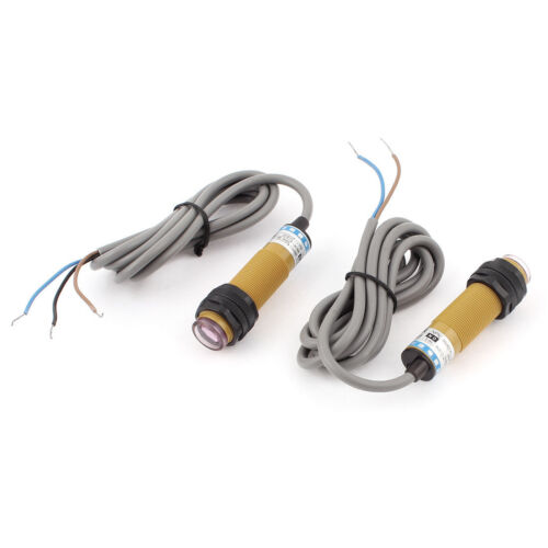

I have 24 pairs of these:
which will work with 6-36v each. I'm trying to power the receivers with a 12v 2a supply and the IR transmitters with another 12v 2a supply. Since the manual is in chinese I can't find the current draw or any other relevant info but the wiring color code schematic is fairly straight forward:
receiver has pos voltage (6-36v), gnd, and the signal which is whatever voltage is being fed to it when the beam is being received and then 0v when the beam is cut.
The ir transmitter is just pos voltage (6-36v) and gnd.

In the eBay listing it seems to indicate 300mA, whether that is current draw or current passing of the switch I can't be sure. The attached image seems to show something that looks like 300mA on the two parts.
You're right, it does say 300mA. I'm thinking that part of my multimeter might actually be damaged by high current one time. I just tried it with a cheaper one i had that wasn't presumably blown and i'm getting 210mA
it surprises me that the receiver would draw that much current, but i guess that makes sense now. I guess that also explains the voltage drop
The transmitter is likely 300ma max and the receiver would switch 300ma max. The circuitry in the receiver might use 10-20ma too. If going with optos you'll be switching 10ma.

I'm guessing that the sensor has an internal 10K pullup resistor (I've seen this on other similar sensor types). Powering it with 12V and trying to achieve 3.3V output voltage, I would definitely use a resistive voltage divider. Try connecting a 3.6K resistor from the NPN output to GND and see if the output voltage switches from 3.2V to near 0V. Note that 300mA current rating would be the rating of the internal NPN transistor. The Arduino Due's inputs would be protected by internal protection diodes ... you'll have no problems if you make sure this current is <= 1mA. Therefore, if the sensor has an internal 10K pullup, then the output could be directly connected to the Due and the protection diode current would be (12-3.3)/10K = 0.87mA. However I recommend using the 3.6K pulldown as described earlier. Please test the output voltage with the NPN on and off prior to making connection to the Due.
