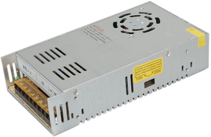

I'm trying to power 3 nema 23's and my setup is using 3 tb6600 drivers and one of these power supplies:
Can somebody please help me figure out what battery will work with this stuff?

That power supply converts 200 to 240 VAC from the AC mains to 24 VDC, where does the battery come in?

Steppers pull lots of power all the time, batteries aren't usually feasible for a stepper motor system.
Also a 15A supply is overkill, thats 120W available per motor.

Also... I'm guessing that the large power supply is why my motor is getting so hot.

Steppers get hot, they run at full dissipation all the time.
Would something like this work then or would I need a 24 volt?

Try it with a bench supply - if 12V is enough, you'll quickly find out!
