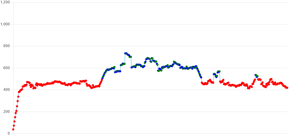

The story changes when I try to do something a bit more complicated: I've set up a current transformer with a filtered half-wave rectifier to be able to detect when a very small load is placed on an AC circuit (<1W):
With the Arduino powered by USB, things look great:
I start recording, count to 5, flip on the power to the device, count to five, then turn it off again, count to 5.
I'll let the 12V graph speak for itself:
Awful!

What are you using to power it via Vin? How does the supply noise look, it sounds bad to me.
These are two of the power supplies I've tried, with identical results. The one on the right normally powers an external HDD enclosure, and I HOPED that if it was a noise issue, at least that one would be a bit more consistent. As far as how noisy they are, I unfortunately don't have a scope to properly analyze their signals. If they were noisy, would there be something I could do to clean them up before feeding them into Vin to test that out?

Have you looked at the "12V" supply with a 'scope? There could be a lot of noise on it and I dont see any decoupling on the breadboard.
Why do you think the Vin limit is 12V and not the 20V that the regulator can take? Because 12V limits the max current to only what the card needs - no reserve. Higher source voltages can only deliver LESS current, as the higher voltage causes it to go into thermal limit at a lower current. (Remember that Power = V Γ— A) At anything higher than 12V, the current is insufficient to power the card. Cutting the source voltage at Vin will help.

You can get a feel for the noise on the 12V line without a 'scope, by using your voltage meter. After checking that 12V is actually 12V on the 20VDC scale, switch to the 2V VAC scale, or even the 200mVAC scale, and you can directly read the "noise" floating on the DC. Now this is not super accurate, but a SOLID 12VDC supply should read essentially zero, even on the most sensitive VAC scale. If you're getting "bouncing" VAC readings, you've got a noise issue.
Do t forget the A/D is using the chip supply voltage as it’s reference.
If the regulator is heating up that reference may shift , use the internal reference.
Your voltage divider should use resistors in the 1-22k range .
Does the CT have a burden resistor ?’
Bread boards are well known for bad connections .
I'm not sure if it's related to the noise issue, but you MUST have a burden resistor directly on the secondary of the current transformer. Otherwise with higher currents you can get very high voltages. Typical value would be around 1k.
Just expand on this. If there are N turns on the core, say 100, and the current flowing in the wire carrying the current to measured was say 10A, then the CT would try to force 10A/100 = 100mA through whatever it's connected to. If there is a very high impedance then a very high voltage could result. A burden of 1k would give a voltage of 0.1A x 1000 ohms = 100v which is already uncomfortably large for anything connected to Arduino. So for 10A maybe a better choice would be say 50 ohms which would give 5V max.
For supply decoupling you need electrolytics - say 100uF with a good voltage margin above your intended. A "12V" (average) can be a LOT more esp if only half wave rectified.

Tell us more about that "very small AC load". Using a current transformer without burden resistor can be deadly to the Arduino pin. Why don't you measure AC voltage with the processor instead of rectifying it first (with a diode with a 0.5volt threshold).

I'm actually using the internal 1V0 reference for these measurements, I didn't make too big of a mention of it though, just in the calculation, sorry! I don't have a burden resistor, just looked that up and I think I've gotten away with it so far because the load on the primary winding is so minuscule. I'll definitely get one in there though, thank you for the suggestion. As far as the breadboards go, if they are known for bad connections, mine is almost certainly having bad connections, it's a chepo that came with a cheapo kit so I'll see what I can do about getting a better one (or just dead bugging the components.)
Thank you for the suggestion, I didn't realize about the burden resistor. As I mentioned to hammy I think the only reason it hasn't fried my poor little dude is because I have such a tiny load on the primary side, it's pulling MAYBE 5-10mA tops. Product sheet says 1W but that is definitely an overestimate given the readings I've seen.

Er, I doubt this would work because most DMMs do not have AC coupling on their AC input. You could however insert a suitable series capacitor to block the DC and then put the DMM on a low AC range.

That trick works. DMM's must be AC coupled in order to read AC. If the OP's DMM is reading OL on the low AC settings, then there is a TON of noise on that line -- poorly filtered pulsating DC.
The power module shown has "universal" input range, that means its a switching power supply. Switchers generally need a minimum load of around 10% to maintain regulation. Additionally, they are a noisy source with the switching noise poorly filtered.
The module is rated 12V at 2A, 10% of 2A is 200mA. Bet your draw isn't enough to keep it in regulation.
