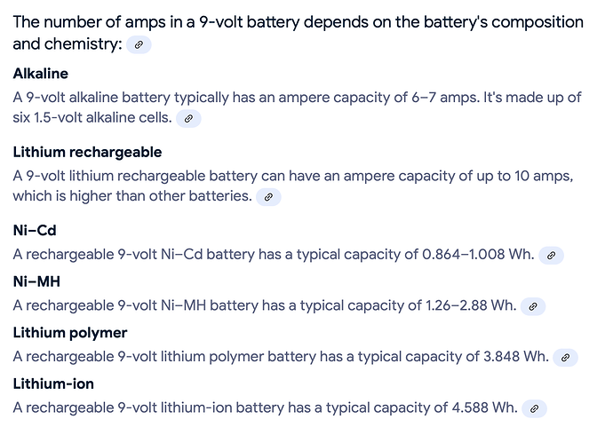

Show me the alkalines with 6 to 7 amps.
Thanks for your help thus far. I could be mistaken about the alkaline battery amps, it's just what I saw on Google:
I'm not sure what the minimum amp requirement would be for this project. The sketch does include a WiFi connection, some UI configurations, and touch recognition. I can upload the sketch if that helps.
