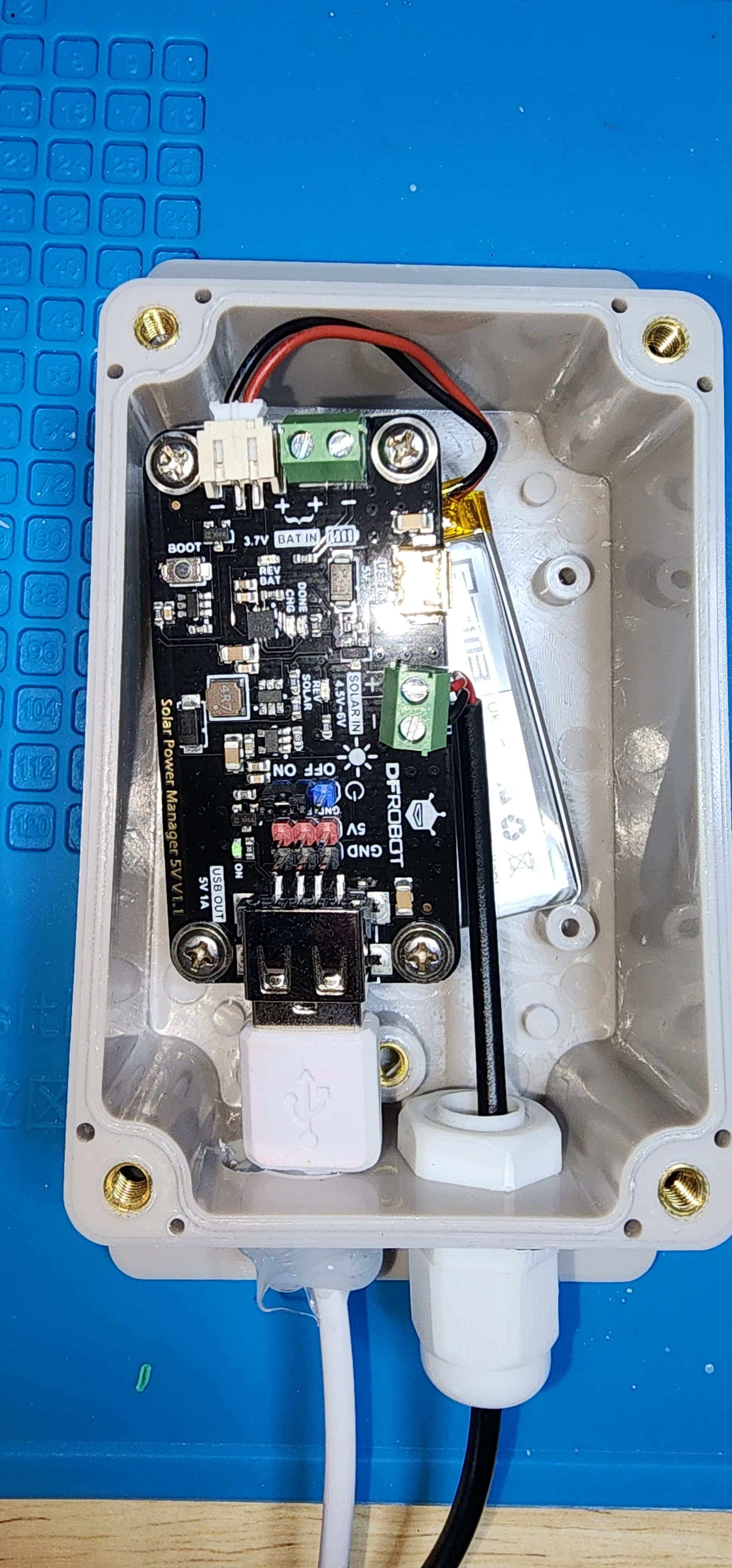

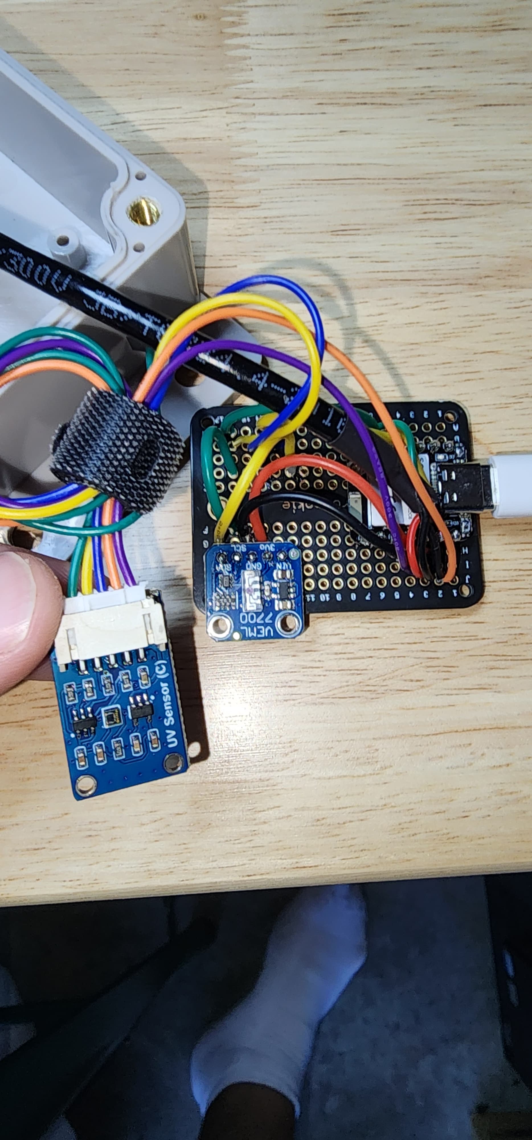

I have a Xaio SEED ESP32C6 programmed with Arduino IDE to utilize VEML7700, BME280 and LTR390-UV. I wanted to get this outside so ordered proper kits and whatnot to provide protection from elements. As part of that, I got a DFRobot 5V/1A Solar Power Manager. Link is here: Solar Power Manager with Panel (5V 1A) - DFRobot
When I run the project plugged into my PC's USB port it works just fine. When I plug it up to the Solar Power Manager, the red LED on the C6 stays on for around a minute and then shuts off. No activity whatsoever after that unless I unplug and replug. The boot button on the Solar Manager gets no response from the ESP32C6. I thought this thing fit my requirements for the project, but something is amiss and I don't know what. Any help appreciated!
You don't mention anything about your battery...
Hello,
Sorry. It's a 3.7v 2000 mAh battery that is plugged into the Solar Manager. The Solar Manager is supposed to keep that battery charged.via the solar panel.
Make sure you first charge that battery completely, then try to power your Esp. That tiny solar panel alone is probably not able to power it.
The battery is fully charged and Ive tried two different batteries, including two 18650s in place of the standard lipos that connect to the solar manager. I may have to add Bluetooth Serial to see what is happening but Ive not played around with that library much.
Do you have any of the reverse polarity LED on?
Feel free to post your wiring scheme and/or photo of your setup.
The manager will warn you if your polarity is wrong on the battery or solar panel and has very clear markings for positive and negative connections. That was a good thought though.
That's why I asked.. So if all the LEDs are indication OK, you need to start playing with multimeter. Measure continuity for common ground in every point, measure Manager regulated 5V output V, Esp 5V input, Esp operating voltage etc.
Crap usb cable? Solder bridges somewhere?
I really see only wires on photos, not where they go... :wink:
Will break out the multimeter tomorrow and report back. The circuitboard is miniature breadboard type, so didnt have a lot of area to work with but everything is working correctly when using PC-powered USB port. Haha.
Does your sketch (not posted) have your unit stuck waiting for Serial Monitor?
Put another way - does it "work" if it's running from a 5V_cube (charger)?
I measured this morning and there's no difference whether plugged into Solar Power Manager or into PC USB port. When powered, the used ports of the SEED are getting about 3.24V along with everything attached to them. The unused ports are in the low mV range.
