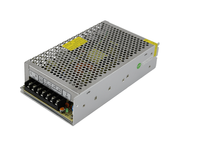

Y, are you buying or building, I wouldnt build a crap PSU if going thru trouble of it...
Are you not allowed to use a ready-made power supply?
If you want to use the thing later buy 12A, if not buy 6A if you are making make at least 10A with protections, and do what groundFungus said...
The thing is.. I have to make a PCB of my main circuit so a little bit like a CNC shield and a Power supply PCB.
So you gonna make it? idk. switching psu is hard to make and transformer costs twice the chinese 12A - they do tend to over rate

If its as u say really tough for a 17yo to build I might talk it over with my teacher and maybe make a simple PSU for idk cooling fans, a light, ... and buy a switching PSU for 30euro's
So if 12V -> 50/12v = 4.1amps something like this? I don't fully understand how I should calculate the current and/or power
