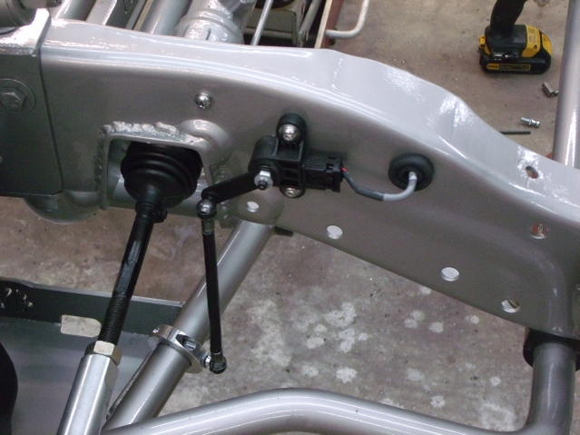

How about just using existing automotive solution called ride height sensors, in other words potentiometer with a lever connected to suspension used to measure ride height for headlight or air suspension control?
When you know your dynamic camber change in relation to suspension travel (as you should in this point) you can calculate the camper based on reading of your sensors. Ofcourse one sensor/wheel is needed to count in body roll and get any meaningful results.
Or was the idea to measure/count in how much your suspension components deform? That's not possible with system described above..
That looks like it might work. It is the sort of thing I had in mind without knowing that those specific sensors exist. Presumably the sensors are designed for longevity in a harsh environment.
My only doubt is whether they would be sensitive enough for the OP's project. I don't know whether ride-height adjustment needs much precision and I suspect it does not need a fast response, indeed a fast response might be unhelpful.

I think there's different types of those, simplest being just kind of analog potentiometer and advanced types being digital with hall sensor and some sort of ic inside.
For example:
Continental Chassis Position Sensor
Programmable measurement ranges, e.g. 4 x 90°
Offset programmable over 360 deg
Sensitivity 0,057 V/deg nom. (programmable)
Supply voltage range: 4,75 V up to 5,25 V
Analog output, PWM, PSI5 available
Temperature range: -40°C up to 125°C
No mechanical stop
Separation of electronics and mechanics
Molded element (no PCB)
Resolution 0,022° (12 bit at 90 deg)
Designed for automotive systems (wheel housing, harsh environments)
In automotive applications those are designed to be used, the adjutment is intentionally slow (for headlight range to not go heywire when driving over a bump for example). However i think it's all done in conrol unit side. At least in analog version it's just a matter of reading it fast enough :slight_smile:

Personally i'd use automotive sensors to automotive applications at least outside the vehicle. Surely about any solution can be made working, but if it's a matter of feasibility and durability (imagine driving in rain for example) i think it's best to use things that are actually made for exact purpose. Spending 30-100€/corner for sensors shouldn't hit race car budjet too hard :slight_smile: https://www.autodoc.fi/topran/9706010
