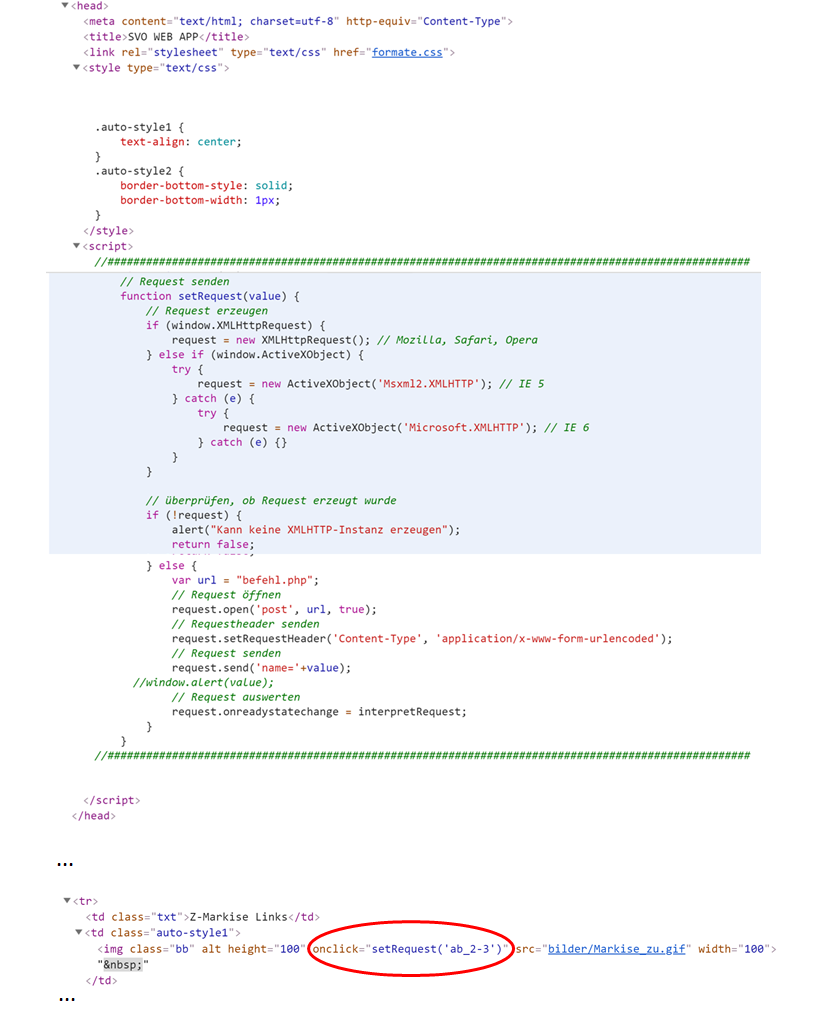

I have a problem with a project I'm currently working on. The shadings in our house are controlled via a homepage in a local network which goes on my nerves because I have to switch between the WiFi's with my phone all the time. So I thought I could use my NodeMCU to controll the shadings, at first maybe just by using the serial monitor.
So far I can connect to the local network an the local homepage but I'm stuck at how to press the button (or actually image).
I have accessed the source code of the local hompage. I think what I need to do is telling the nodeMCU to execute the highlighted "onclick=set_request(id)" command. (see attachment)
Does anybody know an easy solution for my problem?

You will never be able to get the NodeMCU to press a button on a f**king picture.
Post TEXT AS TEXT.
You MIGHT be able to get the NodeMCU to perform the same action as if the user had clicked the button which triggered the onclick() method.
Well, my question is how to do that?
I only have the screenshot available at the moment, but I can post the source code as text later on if that is of any help.
Thanks anyway and kind regards
Alex
It will be necessary.
I got a hint from somebody else how to solve my problem and it's working now. I wanted to share my solution with you, maybe it's useful for somebody else.
What I needed to do was using the software "Fiddler" to see what message is sent when I press the button. In my case a page "command.php" is called and the data "name=blind_1_up" is sent. Also the content type used in the code can be obtained with Fiddler.
