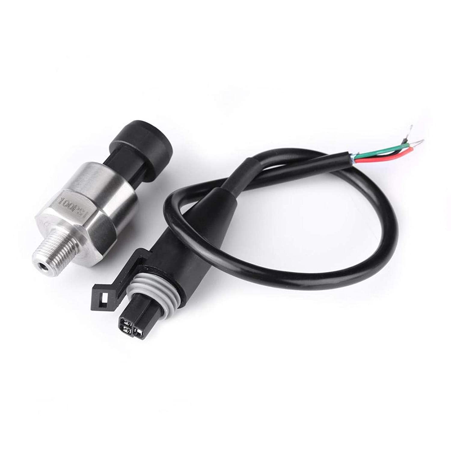

Hi, I am trying to build a water pressure sensor with a cheap 100 psi pressure sensor off Amazon, I am using an Arduino Uno and have followed a guy on Youtubes tutorial, however the output is floating ie when no pressure the output is reading 6 - 8 psi, I know the resolution is 10 bit but my question is would a higher resolution help me and could I use an add on board ?

The sensor used is this one:

If you are getting a reading of 6 - 8 psi with no pressure applied then I think you need to edit the value assigned to 'pressureZero' in the following line:
const int pressureZero = 102.4; //analog reading of pressure transducer at 0psi
Note that a value of 102.4 isn't an integer.

That means that the pressureZero value must be lowered a lot, maybe to about 55.
Change the value and upload until it displays as close to zero as possible.

The first thing I would do is to print out the raw pressureValue in counts. This eliminates any code / conversion error.
The next step would be to add a 0.1µF capacitor to the input of the Arduino A/D pin to the closest Arduino ground. And add a 5k to 10k resistor in series with the pressure sensor signal. This will filter out any "noise" on the signal that could cause unstable readings.
Assuming the pressure transduce and the Uno are both connected to the same 5V. Then:
  • sensor voltage for each psi = 5/100 = 50mv/psi
  • A/D voltage for each count = 5/1024 = 4.88 mv / count
This gives you ~ 10 counts for each PSI. Adding resolution will give you no benefit.

This type of pressure transducer is notorious for zero pressure issues. The sense element is a disc of stainless steel with a strain gauge attached to it. Its very difficult for the mfg to keep the element from "oil canning" at zero pressure.
So I wouldn't worry too much about an offset at zero pressure.

Sensors like this usually have a limited output range of 0.5 to 4.5volt on a 5volt supply.
So only about 800 counts of a 10-bit A/D. Not quite enough to display 100 with one decimal place, unless you take multiple samples and average (smoothing code).
Can't say 50mV'psi (or 40mV/psi) either, because sensors like this are ratiometric, so mV/psi is supply dependent. Just stick with A/D counts per psi, and forget about 'volts'.

So assuming it is a 0.5 to 4.5V sensor. That would put zero at approximately 102 counts.
To understand what the sensor is actually reporting, add the following print statements to the code you have now. They report the raw analog readings.
When the sensor input port is exposed to the atmosphere, the value that is reported should (later) be subtracted as the "pressureZero" offset. Let us know what you find.

102 is in the original code, and OP said that zero pressure displays 6 to 8 psi.
That makes me think it's a 0.25volt to 4.75volt sensor.
That would put zero at 51.

I didn't read through the code (not my strong point). However I've seen a LOT of pressure transducers working in automotive and I've never seen a 0.25 to 4.75. I can't say such a transducer doesn't exist but it would be a rare bird.
Without additional information I would say your suggestion of 0.5 to 4.5 is most likely with the remainder being just a poor zero on a low cost pressure sensor. But I guess well see....
First random Google hit.
Leo..
