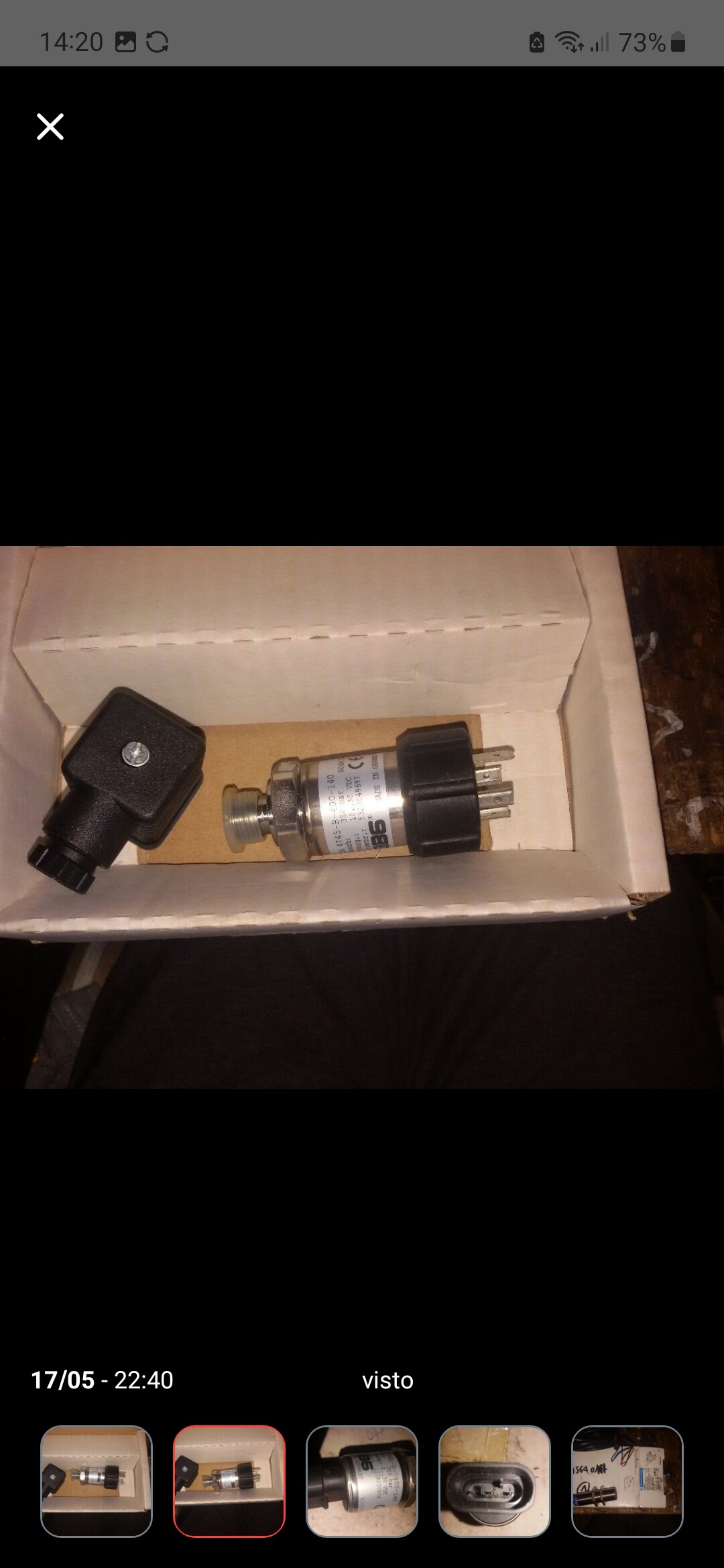

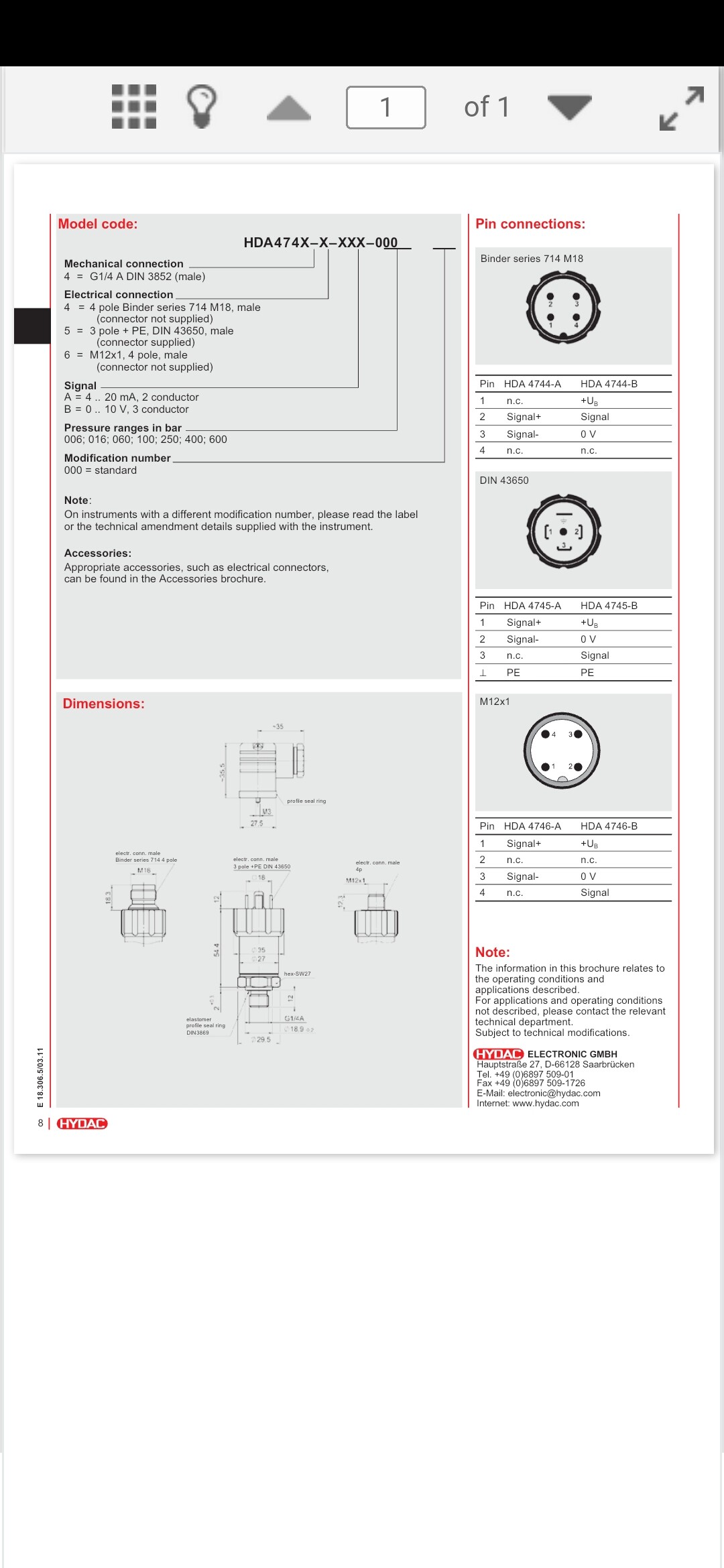

I was thinking to buy this in the picture. It has a supply voltage between 8-30V and an output of 0-10V (name: hda 4745-b-400-140).
Do you know if there is any code available to run it?
I would contact the manufacturer
What project, what pressure.
The image you posted seems to be a 400bar sensor.
Is this correct?
Code can be simple.
float pressure = map(analogRead(A0), 0, 1024, 0, 401); // pressure in bar
Leo..
