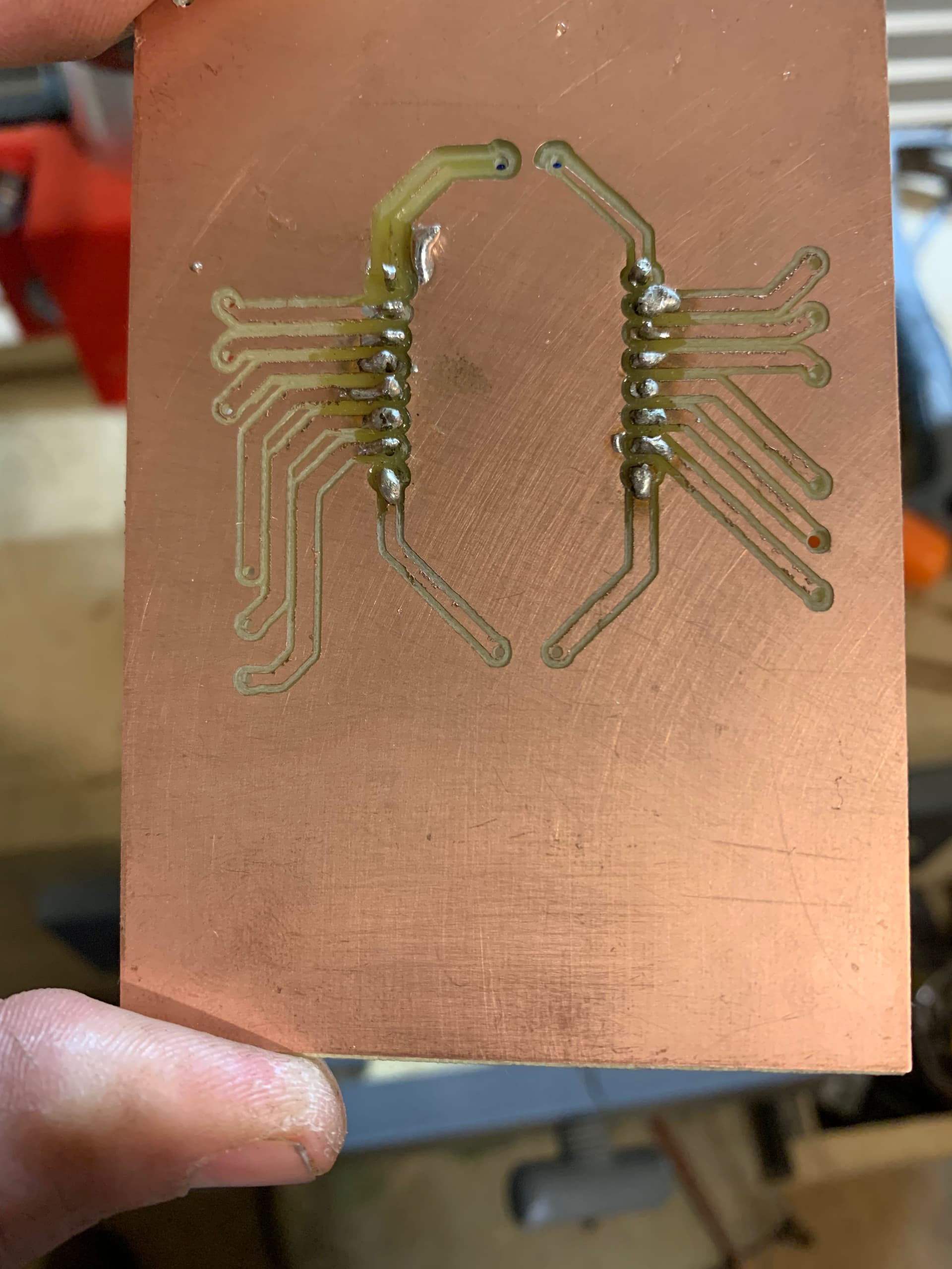

Actually, I have a cnc router and I just recently bought some bits and blank pcb boards. I have not done anything with them. I bought the bits and pcb with the intentions to eventually create a easier to connect to pcb for this mill. However, I have a feeling that is going to be quite the learning curve in itself….
I am really not sure if I went that route if I should use the actual mega board or the 2560 chip? I have know idea how to do any of this, but I feel like if I could create a main board with screw lugs for all of my connections, I would be much better off.

The Mega does not really work with a PCB as it doesn't have the pins needed to connect to one. How many pins do you need? There are plenty boards the can easily be pointed on a PCB, some by being directly soldered, some by being plugged into headers.
Im not sure that I understand. I think as of right now I am using 12 digital pins and 4 analog.
What I was planning to do is cnc a pcb board that had female headers. These female headers would be where the male headers of the mega would plug in to. I would then have traces on the pcb to screw lugs that I could connect my wires to the correct pin of the mega. I am using several tip120’s to allow the output of the mega to switch relays. I was hoping to at least include them also to the pcb, so I wouldn’t have multiple boards to connect to. This would allow me to have it all on one “main” board.
I am also using the two separate motor driver boards. I have wondered if I could add the mosfets, relays and whatever else is needed to control my motors via pwm as well. This would truly make it a main board, but I am not sure this is feasible.
However, I have no clue what the best/easiest way to do this is. I am open to any suggestions.

I did make a simple pcb on my cnc yesterday…. Pretty neat…. It was just a test run, but I used fusion to create the schematic. It was a fairly simple design, but I think it is a possibility now. Would it be realistic to create a pcb that I could use with mill and had the components needed to serve as a motor driver for the winch and scooter motor? Or is this way above my capabilities?

Don't use a Mega for that kind of thing, the way you connect is, err, inconvenient. If you use, for example, a Nano Every you can mount it on a PCB either with header pins into a socket or directly soldered to the PCB. Lots of other boards that can be mounted on a PCB easily.
I've never heard of anyone making a PCB on a CNC machine, please show a photo of it, I am intrigued. The usual way is to design it using something like KiCAD or Eagle then use a PCB manufacturer to make it. I use https://jlcpcb.com in China. I think you are in the US, you have https://oshpark.com/. Both make small quantities for a modest price.

Really? You mill out the areas between tracks.
You design it to have complete ground "fill", you do not want to mill out large areas.
Not appropriate for high voltages.

Here is a quick video and few pictures of he pcb I routed. This was my first time trying this. As you can see in the first two traces, my bit was too big and I routed out all of the copper (no good). However, after making a few adjustments, I think it would be useable.
I designed in fusion which has eagle now built in to it. I am a long ways from understanding it, but it did atleast come out useable. I didn't really have any big intentions with this board. I figured I would mess it up, but it was supposed to be for a wemos mini to mount to and the traces run to screw terminals. This just gives me a simple way to connect. Don't look too closely at the soldering job.... Yea, I'm not very good at that either.....
