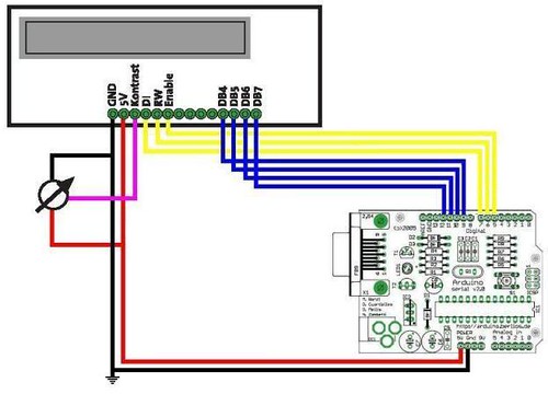

The library is part of the Arduino 0012 download, you can get it from here: http://www.arduino.cc/en/Main/Software
I have not seen a connection diagram for this library but the picture below is how the pins are connected in the sketch I posted above.

Dear Mem,
The diagram & pins of my Surduino differs. The one of my LCD also differs.
However, almost all function pins are identifiable. Almost.
I will try to attach the images of my boards...
Couldn't ..... How do you do that?
I sent you a pm that I hope will help

Wow !!! The sketch code you sent is working fine, displaying decimals on my LCD (GMD1602K
Besides changing the sketch lines and load the new library, I did nothing. I didn´t change a single wire, resistance, nothing.
Contrast is OK too. Backlit is working fine.
