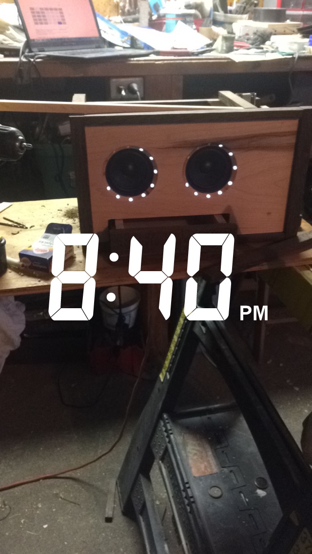

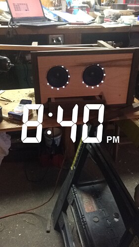

Hello! I'm writing a code to be used with an LED clock, and I'm having difficulty setting up the code to be able to adjust time. I keep getting an error that "print2digits was not declared in this scope". Can anyone help? My LEDs on the front of the box aren't lighting up anymore either. I'm using three pushbuttons to adjust time.

Before you started to add the adjust edit, did the code compile and run correctly?
Thanks.. Tom.. :slight_smile:
Try autoformat on the code. You will see that you are missing a curly bracket. if you put every curly bracket on its own line, mismatches are easier to spot.
It has run before, with the adjust edits in there. What I changed that made it not run successfully is I updated the code with new library functions as before I was using this code

        Wire.endTransmission();
and I needed to update sections where I was using a Wire.beginTransmission into using an actual RTC library
Your void print2digits is probably just stuck inside of some other function on account of curly bracket misuse.
Don't know if it's relevant to your setup, but I had to also
#include <TimeLib.h>
to the RTC examples included in the IDE for my RTC to work
I also needed to include TimeLib.h, however it was for the declaration of tmElements_t tm;
I still cant use print2digits.
Why not using Serial.print(tm.XXX)? This works for me.
I can't juggle horses, either. I'm sure that it will be a lot easier for you to guess why I can't juggle horses than for me to guess why you can't use print2digits.
If you wish, for some reason, to print the hour as 2 digits, when it is 2:00 AM, then that will NOT work, because print() does not print leading 0s.
