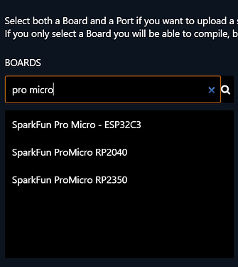

I found the SparkFun ProMicro board in the boards manager, selected it, and connected my board. In the interest of changing only one thing at a time, I again attempted to upload a blank sketch. This time, I got a different red (error) message saying:
> avrdude: ser\_open(): can't open device "\.\COM11": The system cannot find the file specified.
> Failed uploading: uploading error: exit status 1
At the very bottom of the sketch window it says SparkFun Pro Micro on COM11 (not connected). Also, now I get a Windows notification: USB device not recognized. It seems the connection through the port is not working at all now.
So, I think I need to get the board recognized and be able to load a blank sketch with no error messages before I proceed to actual code that does something.

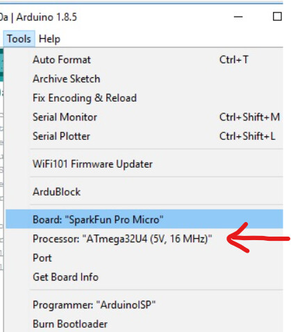

> [@kentm](#):
Is it showing processor: ATmega32U4 16MHz?
<div class="post-metadata">
**Author:** ![kentm](https://dub1.discourse-cdn.com/arduino/user_avatar/forum.arduino.cc/kentm/32/1127458_2.png) [@kentm](https://forum.arduino.cc/u/kentm)\
**Post date:** [May 22, 2025, 3:55pm UTC](https://forum.arduino.cc/t/pro-micro-clone-programmer-error/1383605/12 "2025-05-22T15:55:33Z")
</div>
Where would I find that?
**Author:** ![kmin](https://dub1.discourse-cdn.com/arduino/user_avatar/forum.arduino.cc/kmin/32/1147370_2.png) [@kmin](https://forum.arduino.cc/u/kmin)\
**Post date:** [May 22, 2025, 5:22pm UTC](https://forum.arduino.cc/t/pro-micro-clone-programmer-error/1383605/13 "2025-05-22T17:22:45Z")
</div>
![image](https://europe1.discourse-cdn.com/arduino/original/4X/8/0/c/80cf0d89e8b50cf25464f6073cef6850259ee089.jpeg)
I think Arduino Micro should work as well.

I think that the default setting is 3.3V / 8MHz. If you program a 8MHz Pro Micro as a 16 MHz or vice versa you can use the following approach to get it right.
1. Select the correct clock frequency; it seemed to have worked when you selected the Arduino Micro so it's probably 16 MHz.
2. Upload an innocent sketch (blank or one of the blinkies (see my earlier reply).
3. When the IDE reports the memory usage, double tap the reset button. Upload should now succeed.
I know that a Pro Micro does not have a reset button; either connect one between GND and reset pin or use a piece of wire between GND and reset pin.
