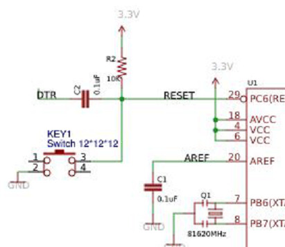

Try putting a 0.1uf capacitor between the Promini RESET pin and ground.
That board does not have a capacitor on the RESEST pin like the Uno or other 328 boards
That did it! Thanks.
I hadn't yet connected the scope to reset. I measured the power rise time which was pretty sharp.
Now looking at the reset, it seems the on board reset cap goes to DTR and not GND. Its one of those things one doesn't really see when looking at the schematic.
Of course this schematic may not match the board I have. I'll have to trace out the Reset Ckt. Also curious why the 328p (i.e. not th328PB) board seems to work.
Have to compare datasheets but the Power on reset threshold between the P and PB may be different.
I'll have to check. In the meantime, I physically verified on these boards the Reset Capacitor goes to DTR not GND. Now looking at the "official" pro mini schematic it is wired the same way, and yet I've never had an issue before with other boards.

That was my mistake it goes to DTR and other boards don't have a cap to ground.
However there can be a big difference in how urboot does a reset as compared to optiboot. Urboot has a lot of options for checking the reset reason and what to do for each. I'm not all that familiar with urboot but I think adding the cap will make it assume there was an external reset.

I prefer to ground the DTR pin when not using a programmer (FTDI serial) because if I put a cap from Reset to ground, in theory with a cap from Reset to ground a reset from the DTR line may only provide 1/2 the voltage at the Reset pin.

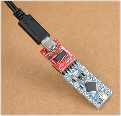

This is true. However, we would typically connect an external USB to serial adapter module (or cable) to the board. Although you could use an ISP programmer instead of that to upload sketches, you are probably going to want a serial connection to the board at least for debugging during project development, so it is convenient to use the serial connection for uploads as well.
The Pro Mini has a dedicated "FTDI header" specifically intended for the connection of an external USB to serial adapter. You can get adapters that have a header with the standardized pinout that allows you to plug it right into the header on the Pro Mini:
USB-C_and_Arduino_Pro_Mini.jpg by Sparkfun - CC BY-SA 4.0 (cropped, border added)

The Pro Mini is programmed via the bootloader from the serial port. I use an FTDI interface board to program this way. This of course requires a bootloader.
I could program this board using the ISP method of programming which will not require a bootloader. Without a bootloader the initial startup may be faster (milliseconds) but cannot be programed via the serial port. If I were to make a production device I would program the processor via ISP.
