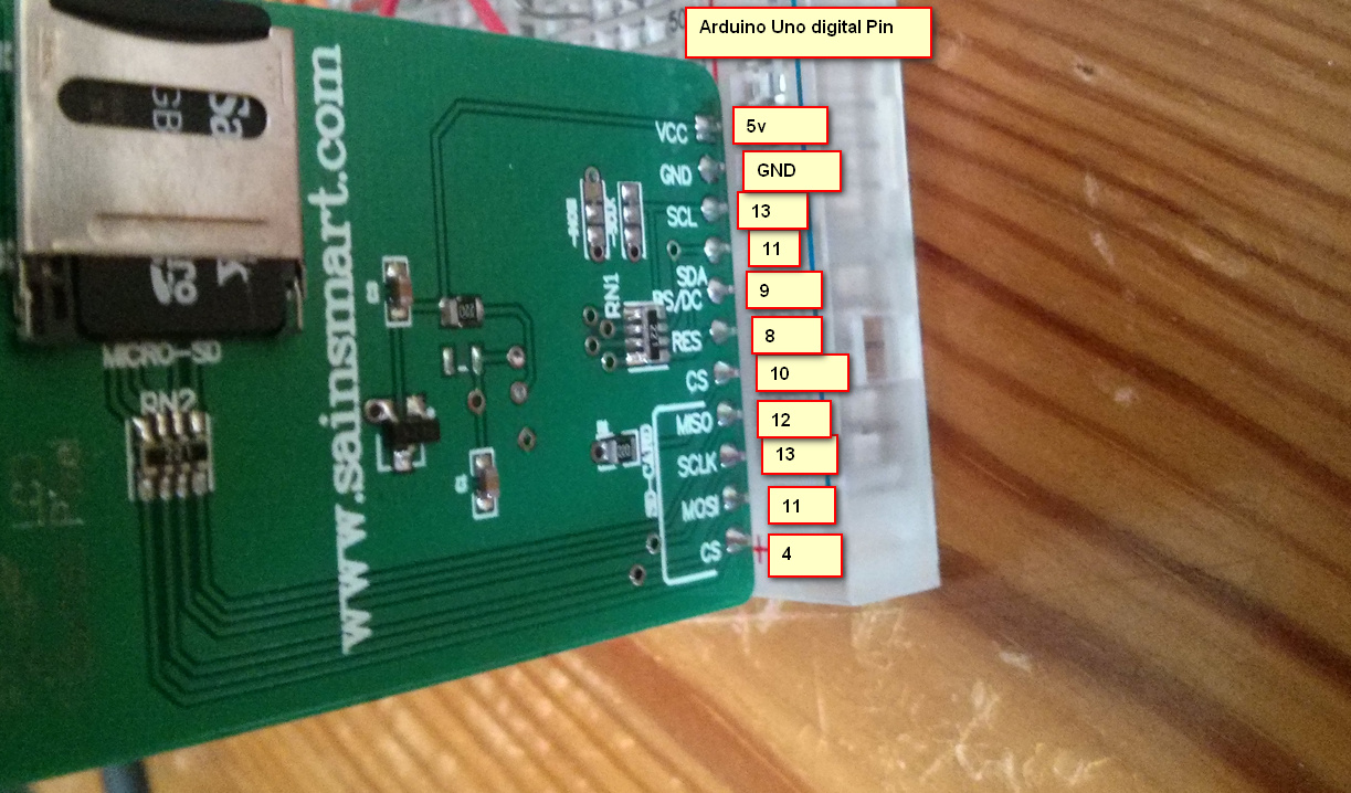

You will have a better chance of getting meaningful help if you provide more information. A link to the 'standard TFTDisplyText example' and another to the datasheet for your display would be a start and a photo of your setup may be helpful as well.

picture of setup

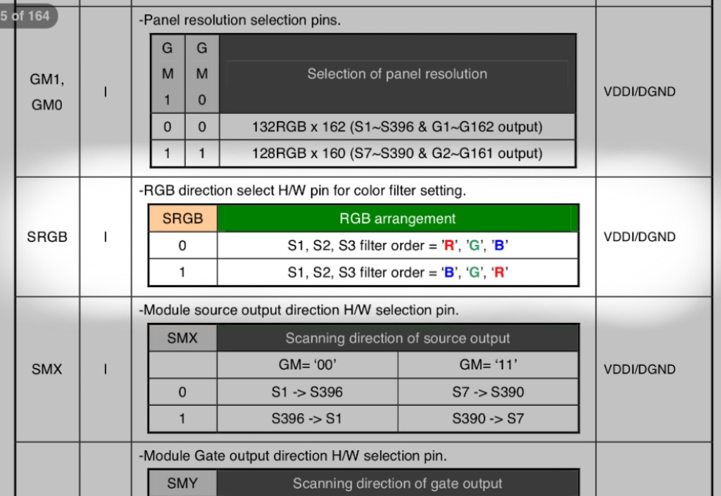

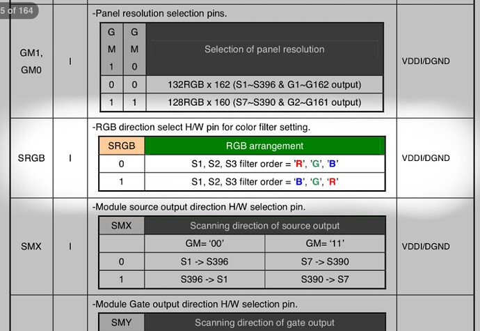

Not certain this is your problem, but....
Did you see this in the datasheet?
I did not, thank you very much, it seems very promising.
However i'm afraid do do not know enough to understand how to use this information. Is there a command i can run in the sketch to alter this setting?
No it is saying there is a pin called SRGB and depending on if it connected to a zero or one depends on the order.
This is pin number 15 as shown on page 12 and page 6.
If you have no way to change this pin then you are stuck with the option you have.
nothing to physically set on the unit i'm afraid. i'll have to live with it.
Thanks Mike,Dave
By the looks of if, since you're getting the GBR order of colors instead of RGB, there is probably a pullup resistor on Pin15 setting it high. You can measure it with a multimeter (when it's off) check the resistance between VCC and Pin15. In case it is not 0 (as in not a direct connection to VCC, or the 3.3v output of the voltage regulator if there is one) you can simply connect that pin to GND, thus enabling RGB mode.

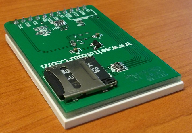

unfortunately there is no access...
exosceleton:
Yeah...might be best to just live with it & work around it. :roll_eyes:
