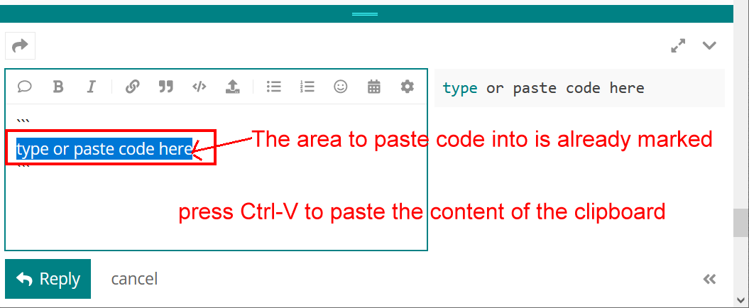

Hi @1j_0000,
you should re-edit your first post to have your code as a code-section.
This can be done with a few mous-clicks.
Below your posting you find a pencil-icon that will activate editing-mode
Click on this icon.
Then mark all the code. Then delete the marked code.
You can post code by using this method that adds the code-tags
There is an automatic function for doing this in the Arduino-IDE
just three steps
  1. press Ctrl-T for autoformatting your code
  2. do a rightclick with the mouse and choose "copy for forum"
  3. paste clipboard into write-window of a posting
best regards Stefan

You should post the content of the serial monitor as a code-section
simply click into the window of the serial monitor
press Ctrl-A, to mark all content in the serial monitor
press Ctrl-C on your keyboard to copy to clipboard
click the insert code-icon </> in the forum
which will create these lines
press Ctrl-V to paste clipboard-content.
