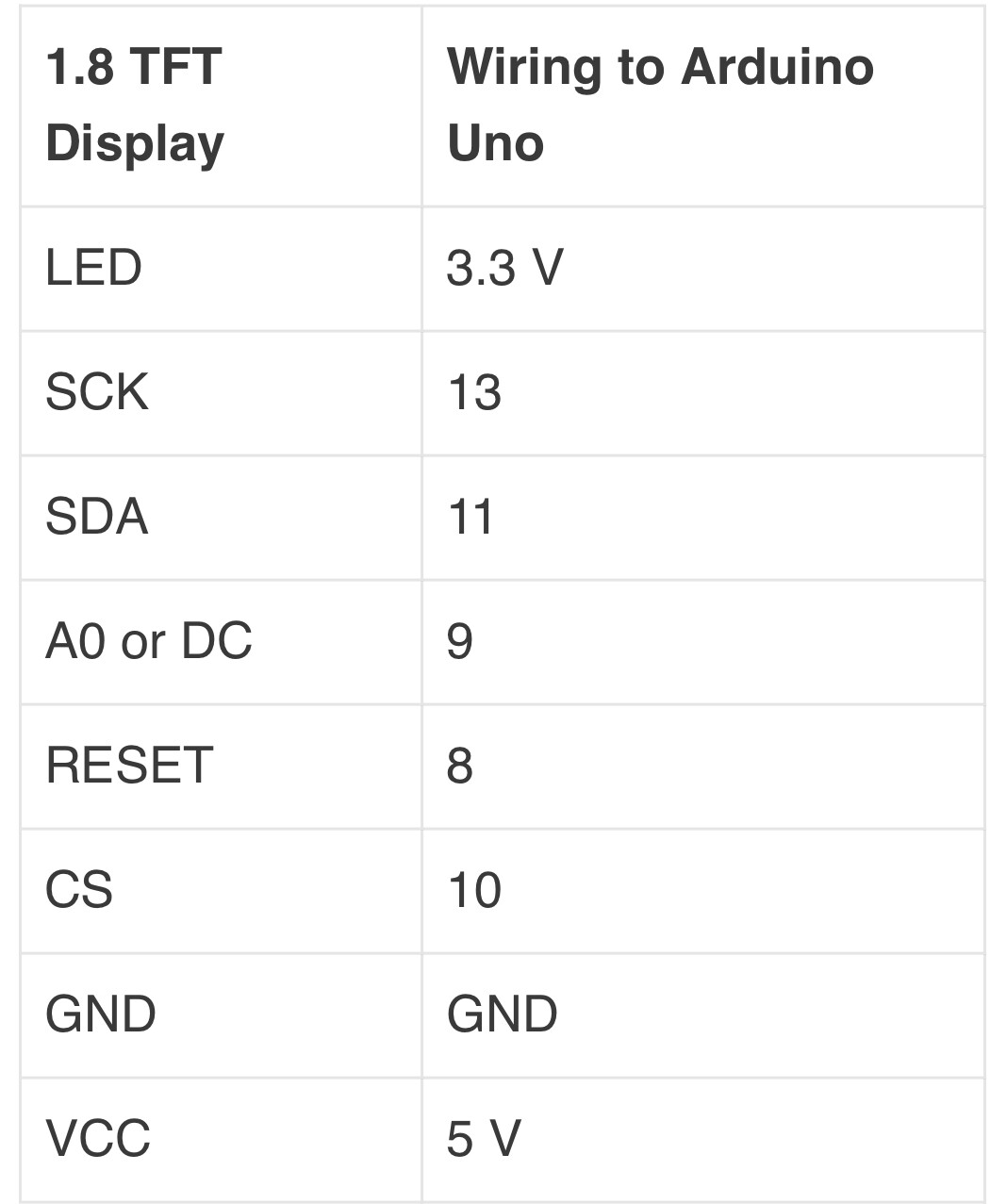

I'm facing an issue connecting a 128x160 TFT SPI display to my Arduino Uno due to limited available pins. The only free pins I have are:
  • D0 (RX) and D1 (TX)
  • D10
  • D13
  • A5
Since I ran out of available pins, I decided to use the PCF8574 module to add extra GPIO pins via I2C. This way, I can free up SPI pins for other components and still control the TFT display.
I wired it like this:
  • PCF8574 SDA β†’ A4 (SDA on Arduino)
  • PCF8574 SCL β†’ A5 (SCL on Arduino)
  • PCF8574 pins P0-P4 for TFT control (SCK, SDA, DC, RESET, CS)
However, the screen is not displaying anything. Could you suggest any improvements to the wiring or code? I'd appreciate any help!
Thanks in advance!
How are you driving the PCF8574 P0-P4 pins? Did you write code to simulate an SPI interface on the PCF8574? Are there timing requirements on the display that may be a problem with the PCF8474?
Thank you for your response!
  1. Driving PCF8574 pins: I’m using I2C commands to toggle the PCF8574 P0-P4 pins to simulate SPI, code I created but not yet tested

It can be done. Whether or not it is practical depends. Here is some code I wrote to run a MAX7219 via a PCF8574. Ignore about 80% of it (related to the MAX7219) and look at the functions with spi in the name.
Can you rearranged whatever you are using the other pins for to free up the SPI pins?

Use the PCF8574 to drive these two devices, freeing up your SPI pins. Also, you gain another 6 possible I/Os (and you can move other devices there to free up pins for DC, CS & RESET on Arduino pins if you like).
The display I am using is a 1.8” TFT. Initially, I wired it as shown in the photo. My question is: to avoid adding an extension module (which I can’t use because only the A3 analog pin is still available on my Arduino Uno), can I connect the screen to the following pins: D1, D10, D13, and A3?
If it is possible to use these pins, how should I wire them correctly?
Here the code that work before when I tested the display :
