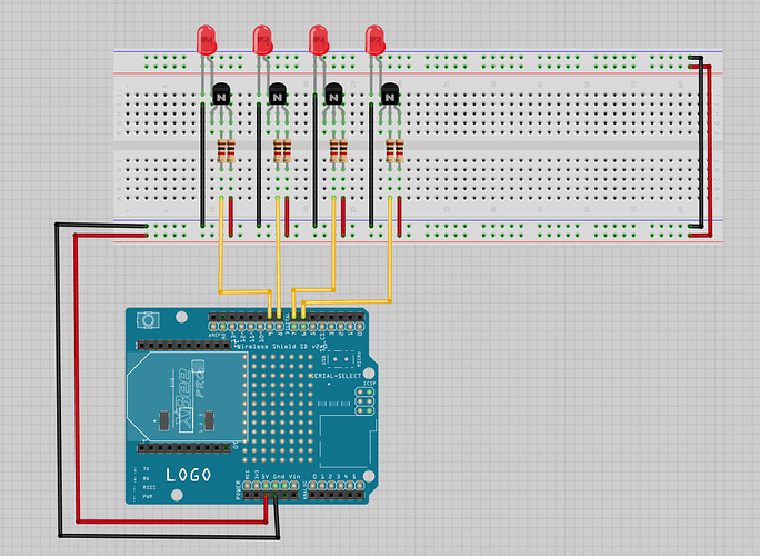

Hi All,
I'm a beginner to arduino and my code is basically a mash-up from various tutorials.
It works perfectly (for me) but with one small issue.
Project Information: I am hacking an Air Swimmer Remote Air Swimmers - Awesome RC Flying Shark and Clownfish! - YouTube
control so that I can control it via web browser.
The code works how I need it to BUT there's one small issue.
After sending the first command every command after that repeats the previous one as well.
Here's my current code:

I know most of you are cringing for how poorly it is put together, but if there is a way so that I can get it to just run the command once without it repeating the previous one? I also attached the schematic if it helps. Just pretend the LEDs are the buttons on the remote.
Thanks a shit-tonne in advance.
I can't test this, as I don't have the equipment, but try this. Reset the variable 'c' at the end of the function CheckForClient with something like 'c = "";'
Again, you'll have to fiddle with it, but that could be a potential issue, that the variable is already assigned going in. But I honestly don't know, just an idea.

        c = ""; // Add something like this somewhere towards the end of this function.  You'll have to tinker with placement.

P.S. What did you use to make that diagram?
Better than the last advice, would be to set c = ' ' ;
It's a char, not a string.
That's a Fritz.
Some browsers apparently send a second request for an icon along with each page request. this could be part of your issue. Below is some code that tells the browser to not update the current web page and dumps anything returned into an Iframe.
