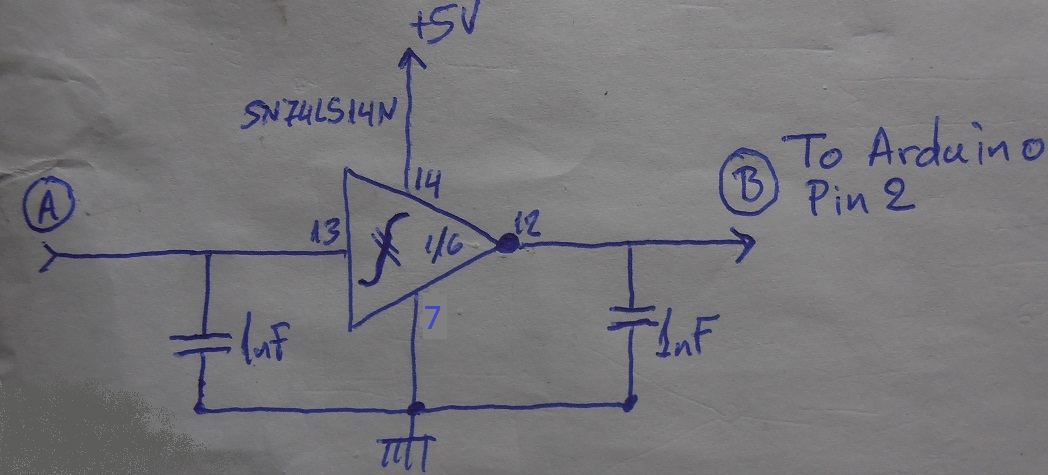

Hello all,
I have been trying to create a diy RPM gauge for a 2 stroke motorcycle. I am not a very good at electricity so I just followed a guide. Bellow are the circuit I used:
My problem is once I start the motor the gauge "works" for a few seconds, then it goes to 0 and stops moving. Occasionally it moves to a few thousand RPM and stops once again. Also the arduino sometimes just freezes. Can anyone please help me?
I have written a few tests, so that I could verify the workings of the gauge and it does work correctly. I have also attached a LED that toggles on a interrupt which works, but freezes for a second sometimes.
Any help would be much appreciated!

Taking the ignition wires this close to the Arduino is likely the reason. The controller faces electrical disturbance.
How exactly does the UNO get its power?
I once, 35 years ago, did the similar to a 4 stroke car and it still worked when removed from the car 10 years later. I remember I used an optocopler. Likely it was situated in the engine bay. I did have an oscilloscope at hand.
The arduino was powered by a 5v phone charger and the 12v rail was powered by a battery pack.
