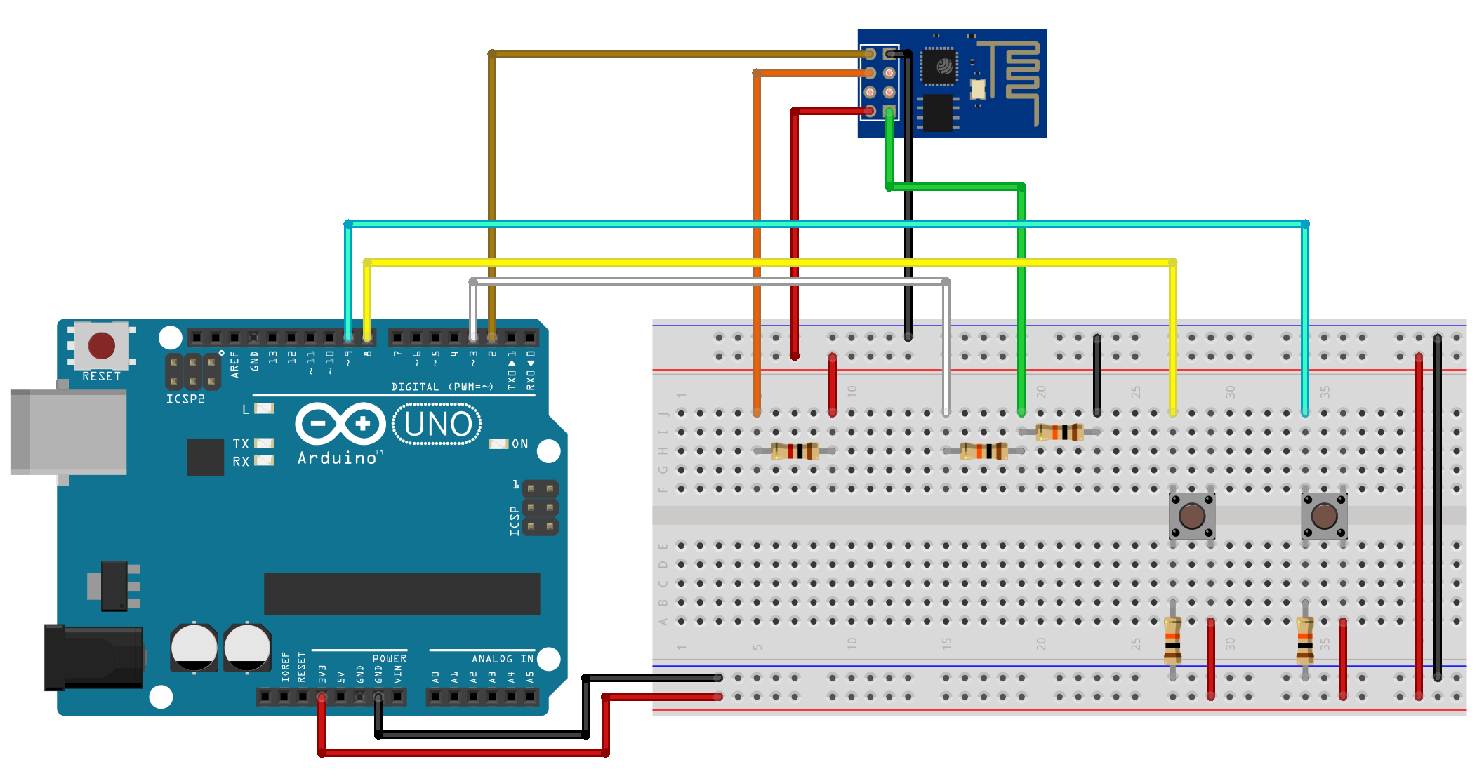

Thank you for your response. I have used NodeMCU before. But I was not able to control the reay. Can you please guide me with total procedure of this project with circuit diagram. It will be very helpful. Can I upload sketch to esp via Arduino bord only?
Saptadip:
What connection did you used? The NodeMCU is good enough to control the relay, you can follow the connection like that picture
Saptadip:
Of course, you can upload the sketcho to esp8266 by UNO board. But remember to set esp-12e to boot mode (GPIO is low) and take out AVR chip on UNO board.
I had used this circuit diagram for flashing esp 8266 12e and it was a great failure. The circuit you have mentioned in your reply for flashing contains serial bus converter. It will be easy for me to use arduino flashing.
