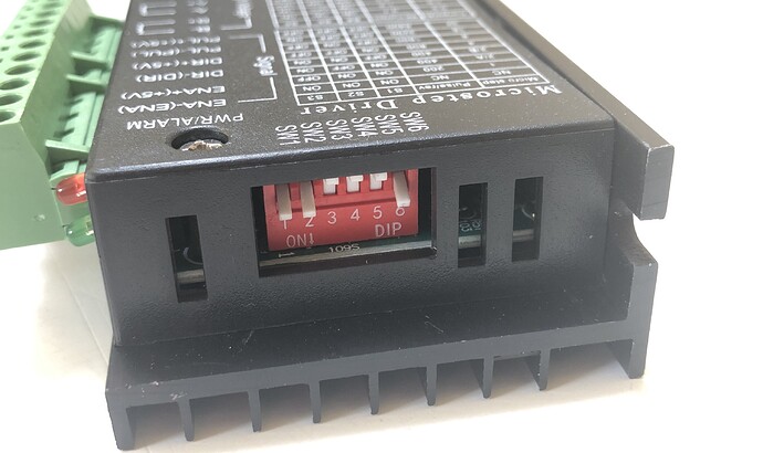

I'm running both drivers in full step mode. I've tried playing with the speeds, and making sure I'm not going to fast, but even when just holding, I would expect to have something close to 2 amps with all of these drivers when driving the Nema 17. I've tried playing with the potentiometer on the board, and that doesn't seem to make any difference. If I play with the current limiting switches on the TB6600, I can make the board pull less current, but not more. It seems that 0.26 amps is about the max.

How have you adjusted the current limit on the stepper motor drivers?

So I 3d printed a one inch arm for the nema 23, and have it hooked up to the TB6600. I attached a bucket with some cord, and I then started weighing down the bucket. After the motor couldn't hold, I weighed everything and it came to about 85 ounces, which is half of what I was expecting. The datasheet says this thing has 1.2Nm holding torque (10.63 lb-in).
I noticed that I have the current limit set to 2.8 because the datasheet has it listed as 2.8 amps per phase. Should that number actually be doubled because there are two coils? Do I need a larger driver that can do 5.6 amps to get the maximum amount of torque out of this motor?
Do not double the current. If the coil current spec is 2.8A, set the driver to 2.8A (or less).
