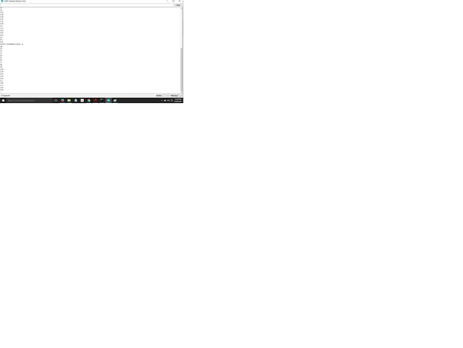

  1. i am working on a project in which i have two radios ,with one radio i am transmitting morse code and another radio audio output i have given to arduino analog input.
  2. in morse decoder program i have made some changes as i am collecting all the incoming characters into a string of length 24.
  3. but every time i send the morse of 24 characters , i get different results
  4. even the first time count is not reaching 24 .
  5. i have attached the code and result of 5 times sending of morse code.
  6. the format in which i m sending morse is ".lat29.3784long089.6424." {without double inverted commas}

Without commenting on the rest of your code, this is wrong:
   y==0;
That does not assign zero to "y".
You also overflow
finstr[24]=0;
Serial.println(finstr);
You don't have a memory allocated for finstr[24] and you overwrite what's after which probably mess up everything.
Declare it with a size of 25 in you need this

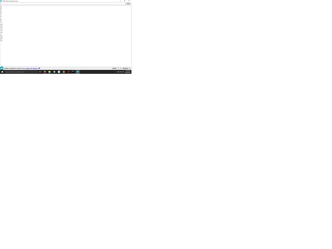

Your png files are unreadable. Post the text instead.

nitish1448:
  1. @ nick : plz see the att result.txt. if i dont declare y==0 before the for loop ,then the count starts from 1 itself ,eating up one full character.
y==0 is not a declaration. It's also not an assignment. It's an expression, which doesn't change the value of y at all. What you almost certainly mean is y=0.
@nitish1448
yes it's an array of 24 so it ranges from 0 to 23. when you try to write
finstr[24]=0;
you write beyond your buffer limit
I think you missed the point. y=0 not y==0, you only use == when doing a comparison.

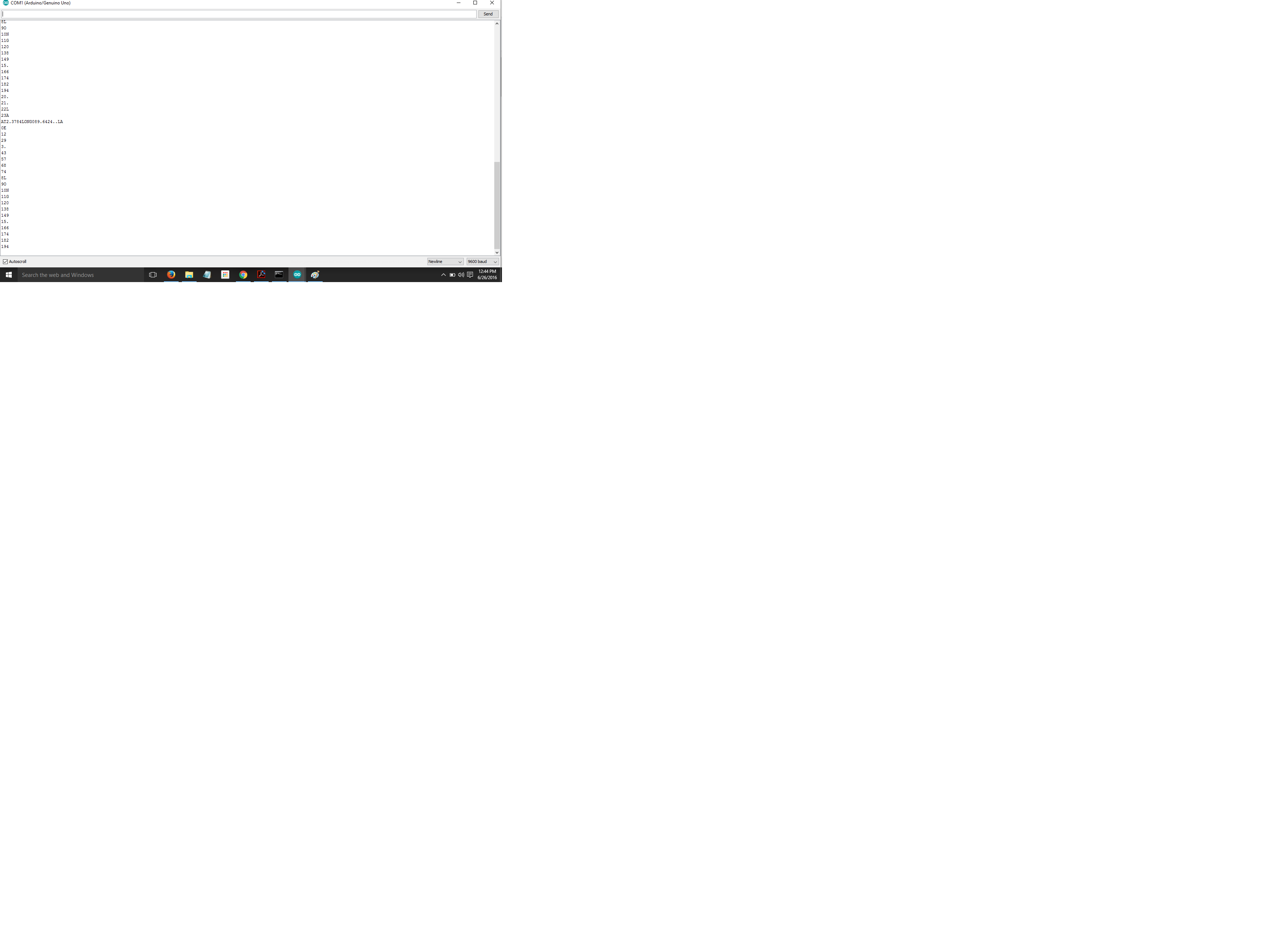

What do you suppose will happen if you send at a rate that doesn't exactly equal 100 baud? Is your "fist" good enough to maintain that exact rate at all times? If that rate varies, how hard will it become to tell and 'A' from and 'R'?
please see the attached file result.txt
only problem is of first character being sent is missed every time.
rest baud rate and all is working fine
