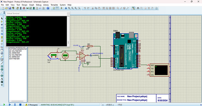

In this project, we are only allowed to use Opamps. I currently have an AD620, but I don't know how to wire it with the thermocouple to measure the signal. Do you have a solution to help me?
Consult the AD620 data sheet for wiring diagrams. Note that the AD620 is not "an Opamp", it is an instrumentation amplifier.
The device data sheet should always be your first and best source of information. The TI thermocouple application note linked above is also very useful.
I followed the AD620 datasheet and found that when I want Vout max = 5V, my Gain should be 90.91 (Vin max of the K thermocouple is 55mV), so I determined that the gain resistor for the circuit should be approximately 560K Ohms. However, when I run the simulation on Proteus, my Vout is not amplified.

Hello, I have solved the signal amplification problem for the AD620, but when I use Arduino to read the output signal of the AD620 and convert it into temperature according to the code below, I find that the read values are deviated from the actual values (specifically, they are lower than the actual values). Moreover, the higher the temperature, the greater the deviation, but I don't know how to compensate for this temperature discrepancy. Please help me.

Unless you give us figures we cant be much help.
You MUST expect an offset as you are not allowing for the "cold junction" which effectively will be ambient temperature.
Also where did you get the magic numbers? Good practise is to define them so we know what they represent.

For a type-K thermocouple, the
voltage changes by 41µV/°C, which approximates the
thermocouple characteristic with the following linear equation:

you seem to have a few wires missing. An electrical signal (a voltage) needs to have two wires so you can see the "potential difference".
SO you need to have a connection to the "protuino" ground.
Do you have a physical circuit or is it all just simulated?
