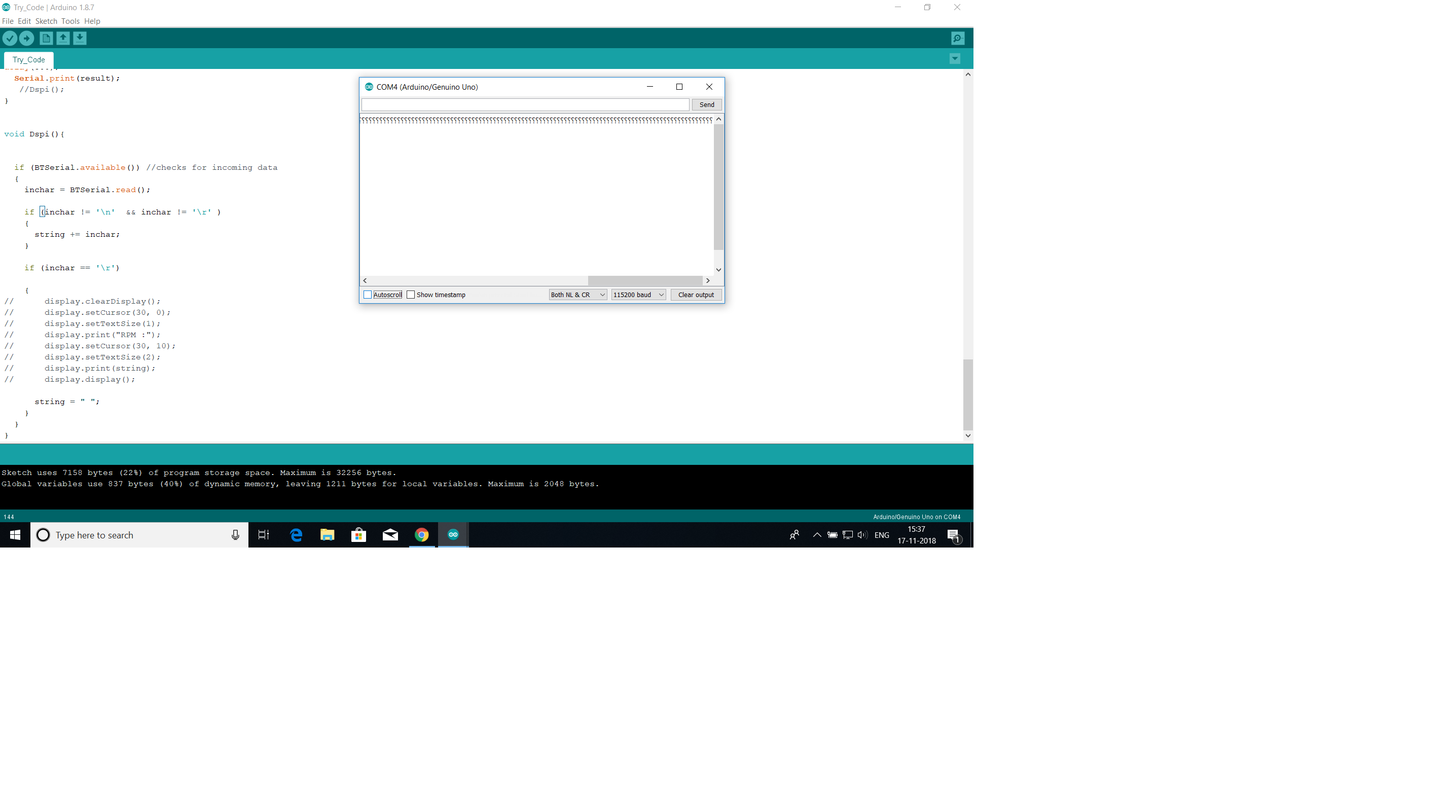

Please Help friend,
I am trying to connect two serial communication device (voice recognition and Bluetooth) so for that, I am using Altsofserial (8,9) pin for Bluetooth and Softserial (2,3) pin for voice recognition.
here I am attaching my code,

The code is running properly but the problem is in serial monitor its showing garbage value like (please check the attachement .
but if I remove the Bluetooth function from void dispi...then serial printer showing proper result
