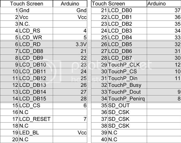

Hey. I bought this 3.2" inch TFT LCD module integrated a Himax HX8347-A TFT LCD controller and ADS7843 compatible touch screen controller as well as a SD card cage. I have an Arduino Mega 2560 and in next image is the connetion between Arduino and TFT.
I'm using Henning Karlsen libraries and when running the calibration program i touch all the 9 cross but in the end the new settings is all 0. I made a program just to get X and Y coordinates and in any point of screen i touch i get (0,0), next is the calibration program i'm running. Any sugestion of has wrong? Thanks.
