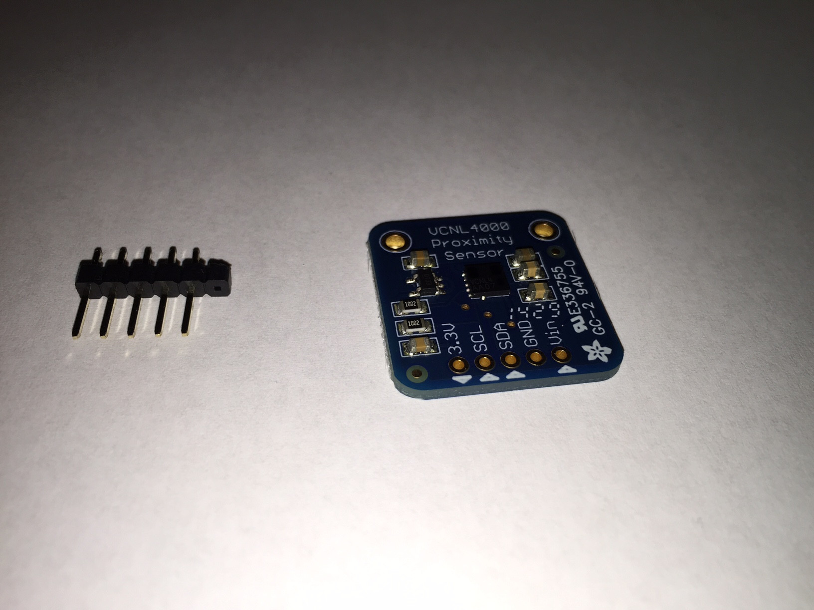

I've the VCNL 4000 Proximity Sensor I use some sample code and at the very beginning
the following code hangs (never finishes)
readVCNLByte(0x81); is called

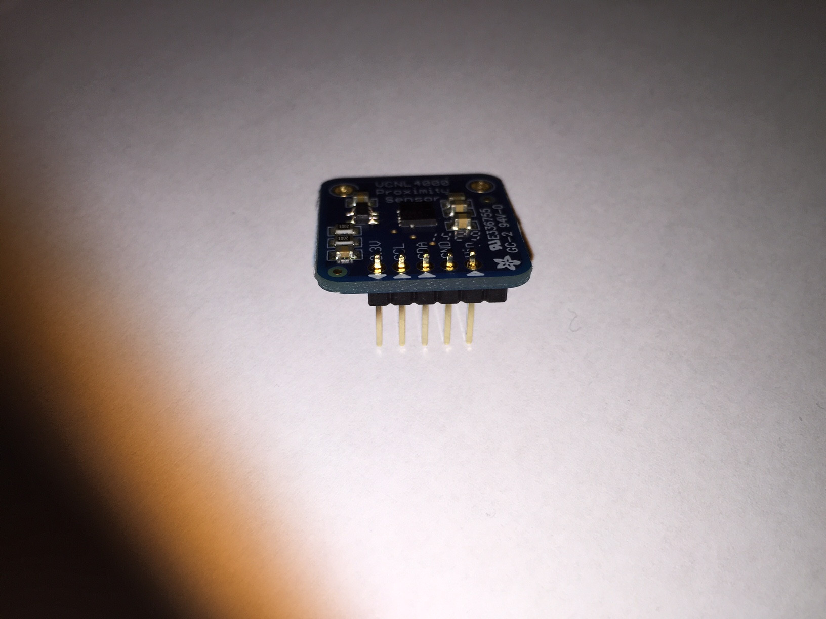

Can this problem be caused because the contact of the pin isn't very good.
I only but the part with pins in the sensor without to solder it.
Is it likely that this may be the problem ? I have not many experince with solder and the sensor is really small so i'd like to avoid it for first tests :wink:
