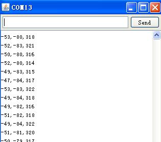

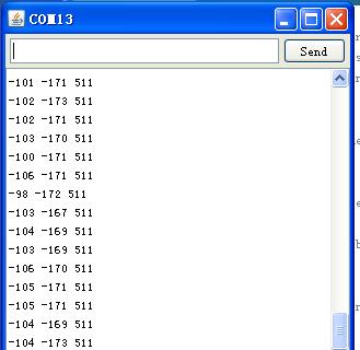

I connect adxl345 breakout to Arduino Uno via I2C and SPI mode respectively. But the output data makes me confused. When the adxl345 is placed on the flat, x, y, z axis data should be approximate to 0 , 0 , 256. In datasheet, 256 represent 1g. But actually, the output data I got is quite different from it. I tried another same board and several examples, the output is almost same as before. Any help is appreciated.
I2C mode:
> **[Triple\_Axis\_Accelerometer\_Breakout\_-\_ADXL345\_\_SKU\_SEN0032\_-DFRobot](https://wiki.dfrobot.com/Triple_Axis_Accelerometer_Breakout_-_ADXL345__SKU_SEN0032_)**
> wiki:Breakout board for the Analog Device ADXL345. The ADXL345 is a small, thin, low power, 3-axis accelerometer with high resolution (13-bit) measurement at up to ±16 g.
CS -\>3V3
SDO -\> GND
SDA -\>A4
SCL -\> A5
VCC -\>3V3
GND -\> GND
![](https://europe1.discourse-cdn.com/arduino/original/4X/4/6/e/46e4b5013adc1ee61f8e2f2ee27cd4c323649574.jpeg)
And when I tilt the board, Z axis data barely changes via I2C.

SPI mode:
[http://www.sparkfun.com/tutorials/240](http://www.sparkfun.com/tutorials/240)
CS -\>D10
SDA -\>D11
SDO -\>D12
SCL -\>D13
VCC -\>3V3
GND -\>GND
![](https://europe1.discourse-cdn.com/arduino/original/4X/b/1/8/b182ef056518104200defbb15ec20d15e27483c7.jpeg)

I used a logic level converter for the said accelerometer. You don't want the 5V to damage it.
> **[SparkFun Logic Level Converter - Bi-Directional - BOB-12009 - SparkFun...](https://www.sparkfun.com/products/12009)**
> The SparkFun bi-directional logic level converter is a small device that safely steps down 5V signals to 3.3V AND steps up 3.3V to 5V at the same time.
<div class="post-metadata">
**Post date:** [April 19, 2012, 2:50am UTC](https://forum.arduino.cc/t/problem-with-adxl345-3-axis-accelerometer-need-help/99647/3 "2012-04-19T02:50:17Z")
</div>
Thanks for your advice, but does it have any influences with the output data?
**Author:** ![liuzengqiang](https://dub1.discourse-cdn.com/arduino/user_avatar/forum.arduino.cc/liuzengqiang/32/213605_2.png) [@liuzengqiang](https://forum.arduino.cc/u/liuzengqiang)\
**Post date:** [April 19, 2012, 3:44am UTC](https://forum.arduino.cc/t/problem-with-adxl345-3-axis-accelerometer-need-help/99647/4 "2012-04-19T03:44:06Z")
</div>
If you supply voltage beyond the max accepted voltage to the device, you are not guaranteed to get anything that makes sense. I would try to use it the right way, then if it doesn't work, maybe it is broken. I've only used it with 3.3V signals and found no problem.

Hello, I am experiencing the same problem. I have 9DOF board from [geeetech.com](http://geeetech.com), it has 3 axis accelerometer, gyroscope, magnetometer and some atmel microcontroller. All of these chips are connected through I2C. For some reason, the ADXL345 returns always value 511 for Z-axis. Y axis shows relatively big offset (it returns values between -512..170), and X axis is working fine (range -337..340)
By mistake I connected 5V source to the board, is there any chance that this is the reason for incorrect reading from ADXL345?
As a workaround I calculate Z acceleration with Phytagorean equation (square root of sum of squares for all three axes sould return value corresponding to 1g), but this doesn't provide very nice results.
Here is a screenshot fom my appication:
Gabriel (www.valky.eu)

You have to do 2 things:
1.Set the offset registers in the ADXL345
2.Make another offset in the Arduino sketch.
Here is some help for you. By looking here at the offset section you'll know how to do the second offset (in the Arduino):
[http://www.analog.com/static/imported-files/application\_notes/AN-1077.pdf](http://www.analog.com/static/imported-files/application_notes/AN-1077.pdf)
And here is a snap of what you should get(the first 3 lines represent the accelerometer):
[http://img210.imageshack.us/img210/88/capturekvr.png](http://img210.imageshack.us/img210/88/capturekvr.png)
After this, is time for some filtering...
Best regards,
RobertEagle
**Post date:** [September 2, 2012, 9:17am UTC](https://forum.arduino.cc/t/problem-with-adxl345-3-axis-accelerometer-need-help/99647/7 "2012-09-02T09:17:42Z")
</div>
Hello Robert,
I owe you a beer! Thank you for your fast response, the application note helped me to fix my problem. The arduino code I am using (Razor\_AHRS) initializes the accelerometer for range +-2g. By switching to +-16 g mode (writing 0x0B instead of 0x08 to register 0x31), I was able to get unclipped reading from Z axis. For some reason it only returns positive numbers even when I set the calibration register to largest negative number (0x80), the x, y axes nicely show positive or negative numbers depending on the orientation of device. But it's ok, I will find average value of Z axis acceleration and then subtract this value from raw value from device.
