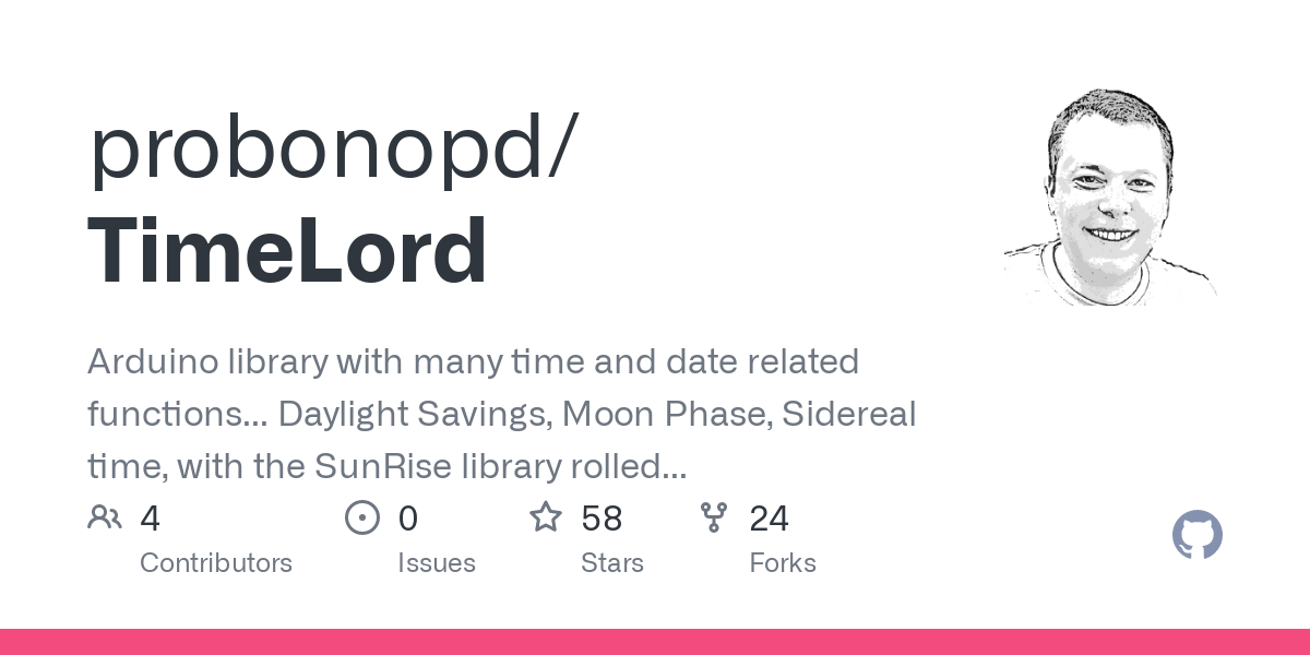

I use the TimeLord library for obtaining sunrise/sunset at my location.
Actually I use it for a time switch in an ESP8266 development. It claims an accuracy of +/- 5 minutes and I verified this by simulation, running through a couple of years and comparing the results from various on line sources. I use the library in UTC and use the native ESP8266 time functions for local time conversion.
In an earlier development, I simply put 12 sunrise and sunset time pairs in a table (22nd of each month) and did a linear interpolation for the intermediate results. These times don’t change substantially from year to year. I seem to remember that the accuracy was around +/- 12 minutes per day which should be good enough for any non critical application.
