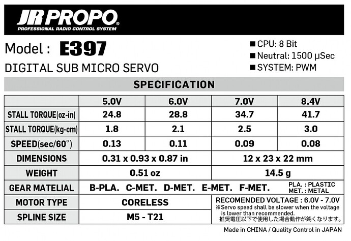

I'm trying to control a digital servo with arduino nano, but sometimes it stuck to certain angle or skip an angle from the code shown.
when i connect the ordinary tower pro servo (analog) it works fine.
I need help, i spent 4 days searching the internet with no luck.
I attached the code, digital servo sheet, serial monitor data.
Thanks,

How is the servo powered ?
Arduino via USB port
Servo powered from 5V and GND pins from arduino nano
Servos and other high current loads require an external power source.
A common ground between the Arduino and external power supply is needed.
How to connect external servo power.
Thank You
Thanks
Thank You All, it works fine, the problem came from the power source, it needed an external power source as you said.
