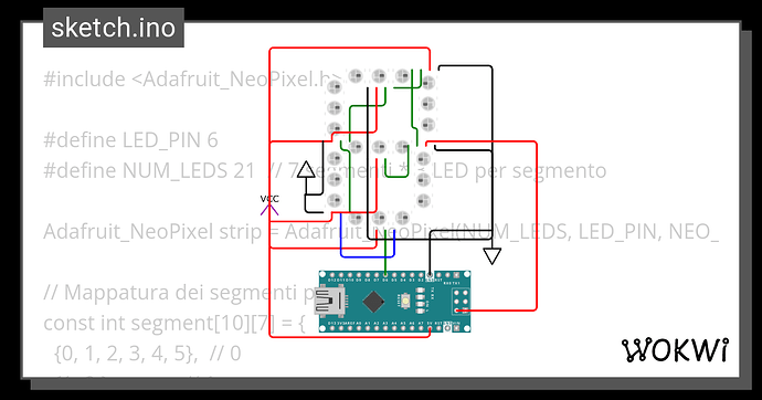

Definitely hardware. Probably after the first three. Here is your code, working...
(edit... pardon the "not shaped as a 7seg"... I like to see it working before making it look good)
Would the first three LEDs be as if segmentIndex = 0 and j = 0,1,2?
If so, it might be from the zeros on the ragged side of this array:

OK, decoding your code and text, the WS2812 led array scans across the 0th segment in each of three digits, and then the 1st digit of the three segments, and so on....
I think I'd mark the un-lit segments in your array with -1 as per #11, turn your loop inside out and make the outer loop digit rather than segment, and as you are cycling through the segments of that digit, choose not to light the unlit segments.

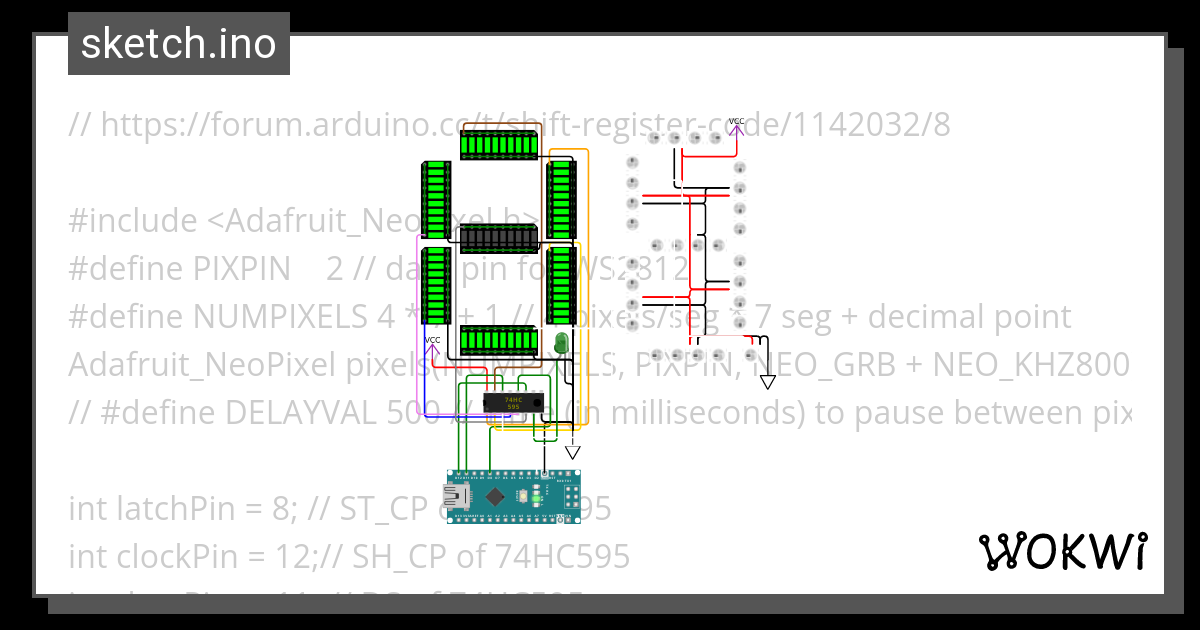

I liked your idea! Tried to put the strips in order, but the wires are a mess. Also had to change some of the OP's segments order.
Mega7sega
