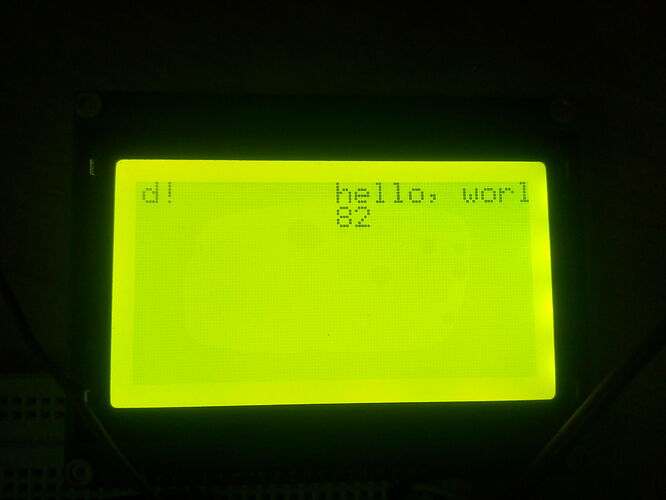

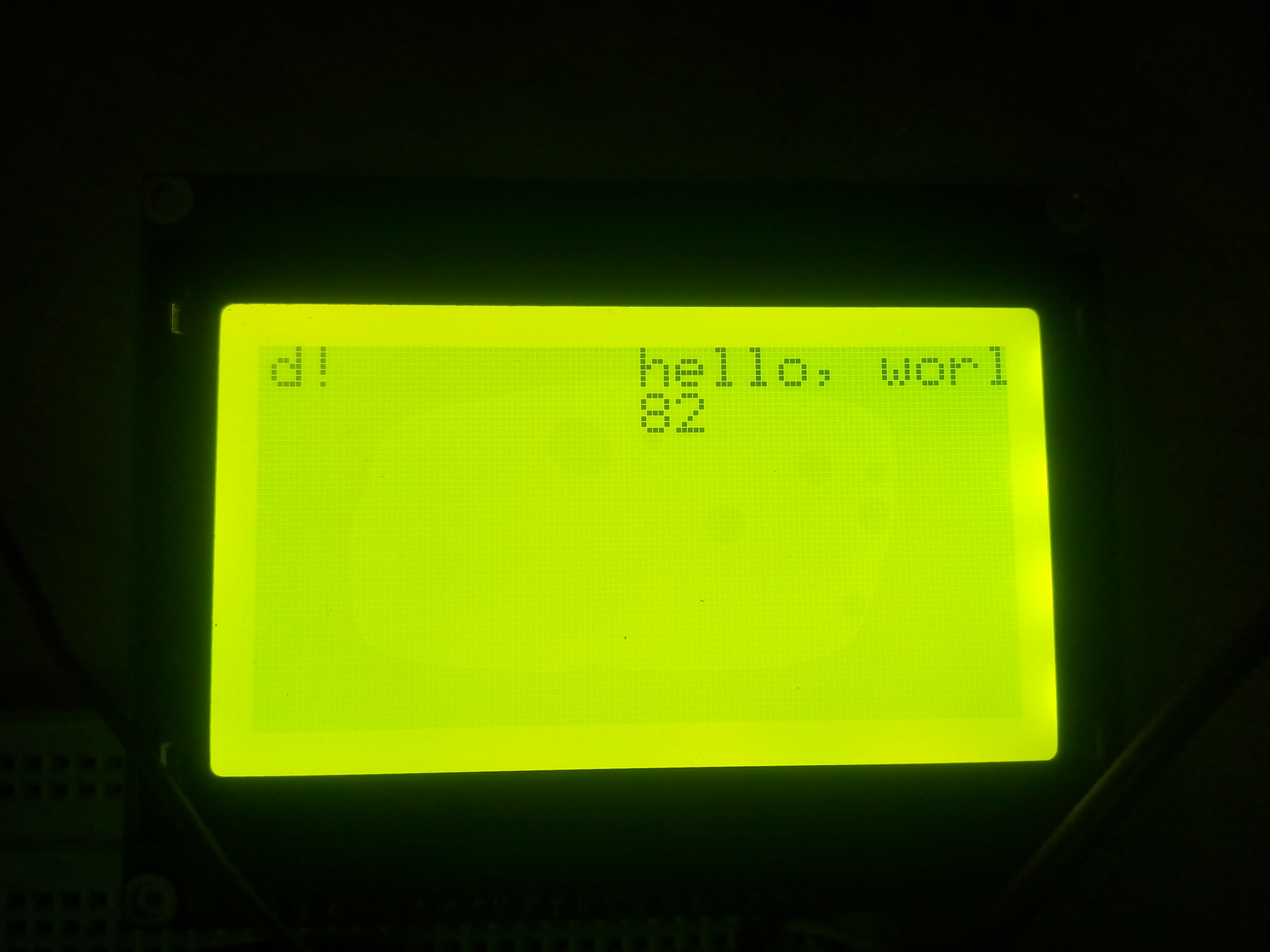

i have problem with GLCD 128X64, JHD12864E.
problem is that when i tried to display any thing then it starts from middle.
like when i set cordinates (0,0) to starts from left top, but it starts from middle top.
like when i upload " hello world " codes to arduino then the characters starts from middle top
of LCD. Here are some images regarding to my connection to LCD and problems.
Swap CS1 and CS2 pins. Typed without looking at your pictures.
Yes that is CS wiring issue.

thank you guys :slight_smile: :slight_smile: :slight_smile: ,
swaping CS1 and CS2 pins really works. thank you david_prentice
