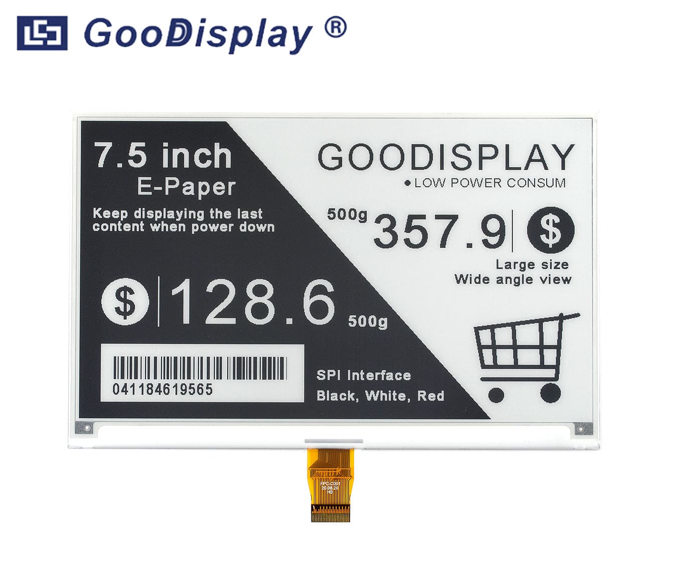

I just bought a 7.5inch Eink Display B&W from Good Display, model is GDEY075T7.

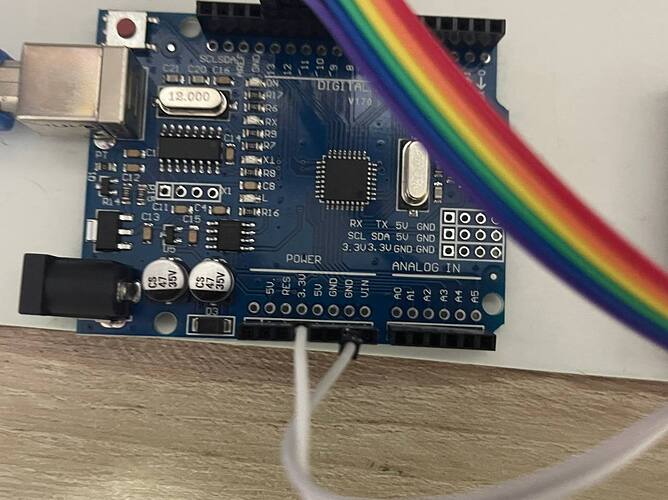

It comes with C02 module. I connected the module to an Arduino Uno (clone), following the pins stated in the sample code and uploaded the sample code to the Arduino.
However, nothing changed on the Eink display.
By the way, the yellow thin cable thing isn't damaged, just slightly folded.
The switch on the C02 is switched to 0.47 (should be 0.47 according to the customer service staff).
I connected the 3.3V to 3.3V, GND to GND.
I also switched to different Arduinos I have and it still dosen't work.

@vnskynet I'm not sure if this will help, but the Uno uses 5V logic on its pins. If your connector board doesn’t have a voltage level shifter, that might be the reason the display isn’t functioning properly. This display only accepts 3.3V and seems to be very sensitive to voltage levels. You might want to try using a 3.3V-based microcontroller or adding a logic level shifter.

Hi, thanks for the help. Forgot to update but I managed to use a ESP32 clone and the display worked using GxEPD2 library a few months ago. The C02 has a built in voltage level shifter thing (apparently). Also the sample code in the website its for their own Arduino Unos and ESP32s and it should be different from Arduino uno clones.
@davidyangarduino UNO have 3.3v pin. Did you try to use? I tried but it isn't different.
