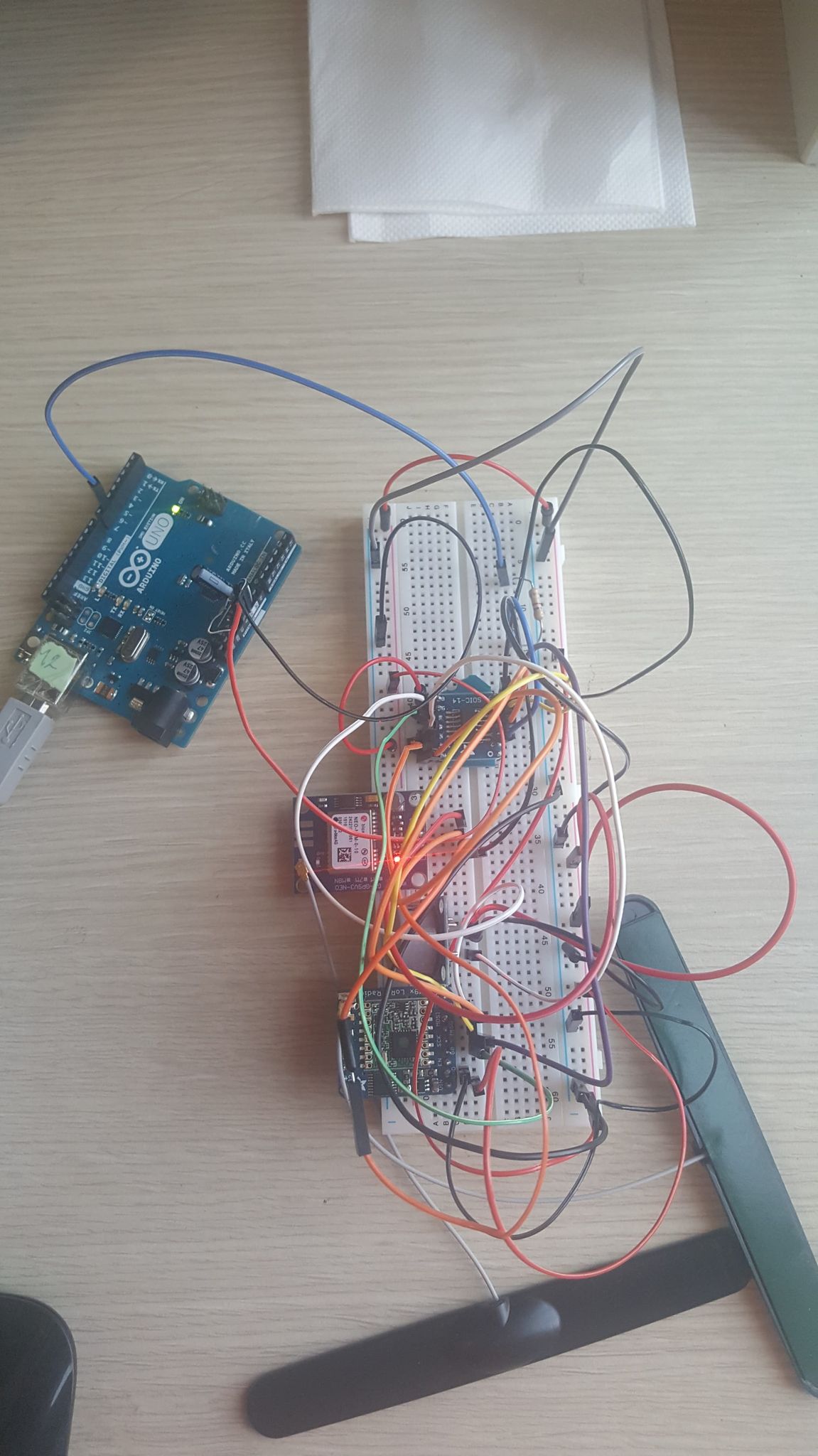

I'm building a device that should detect PM10 concentration values in the air with a simple sensor and send them together with its latitude and longitude to a server using a LoRa module.
I'm using an attiny1604 (I'm kinda forced to use it) as a microcontroller, the adafruit ultimate breakout as GPS module and a RFM9X for the transmission.
The problem is the GPS as I can send and read the PM10 values from the server, while I can only get 0.00 for latitude and longitude. I made tests close to windows and outdoor and I still get 0.00.
I'm using jtag2upidi (megaTinyCore) as programmer and default timer.
For the library I'm using TinyGPS++.
I used "prova" in order to see if the code inside the while cycles works and it doesn't as prova will always be==1.
Here the main code (sorry some comments are in italian)

Wiring diagram?
pylon:
Wiring diagram?
considering vcc as 1:
2 nss of rfm9x, 3 dio of rfm9x, 5 AO of MQ-7 sensor, 6 Tx of the GPS, 7 Rx of the GPS.
considering GND as 14:
13 sck of rfm9x, 12 MISO of rfm9x, 11, MOSI of rfm9x.
I used https://www.youtube.com/watch?v=AL9vK_xMt4E as base for the attiny1604.
maybe it is clear now

Could it be a problem between the USART of the 1604 and the softwareserial?
It is important to be able to read the NMEA output from the GPS module with a minimum of h/w and s/w. I look at the photo of your breadboard setup and think of all the elements in there that might not be working. I hate breadboards. They introduce voltage drops which can stop the GPS working or communicating correctly.
If I have problems I always make sure that the GPS module is producing legible NMEA sentences. I use a TTL/USB converter to do this. This converts the GPS output to USB protocol and that feeds into the Arduino IDE monitor. Simple.
You can also feed the GPS output (just its TX pin) into the Arduino and use a simple (very simple) sketch to read it and send it to the monitor.
GPS projects can have many problems. I feel I am not in charge unless I can easily see the raw data coming from the GPS module -- that is, the NMEA sentences.
Good luck.
John.

Alessandro,
You say everything is working fine but can you show us a screenshot of the NMEA sentences?
The converter has these pins at one end: 5v, TX, RX, GND. You connect these to the GPS module (GPS TX to converter RX). The other end is a USB male connector which plugs into a PC port. The GPS output is converted from TTL to USB protocol and can be viewed in the Arduino IDE serial monitor. The computer provides the power to the GPS.
The first thing to look for is legible sentences. If you do not get these then there is no point in trying to get a navigational fix.
When you get legible sentences take it outside (a laptop?) where you have a good view of the sky. You will see satellite data in the NMEA sentences.
Good luck,
John.
