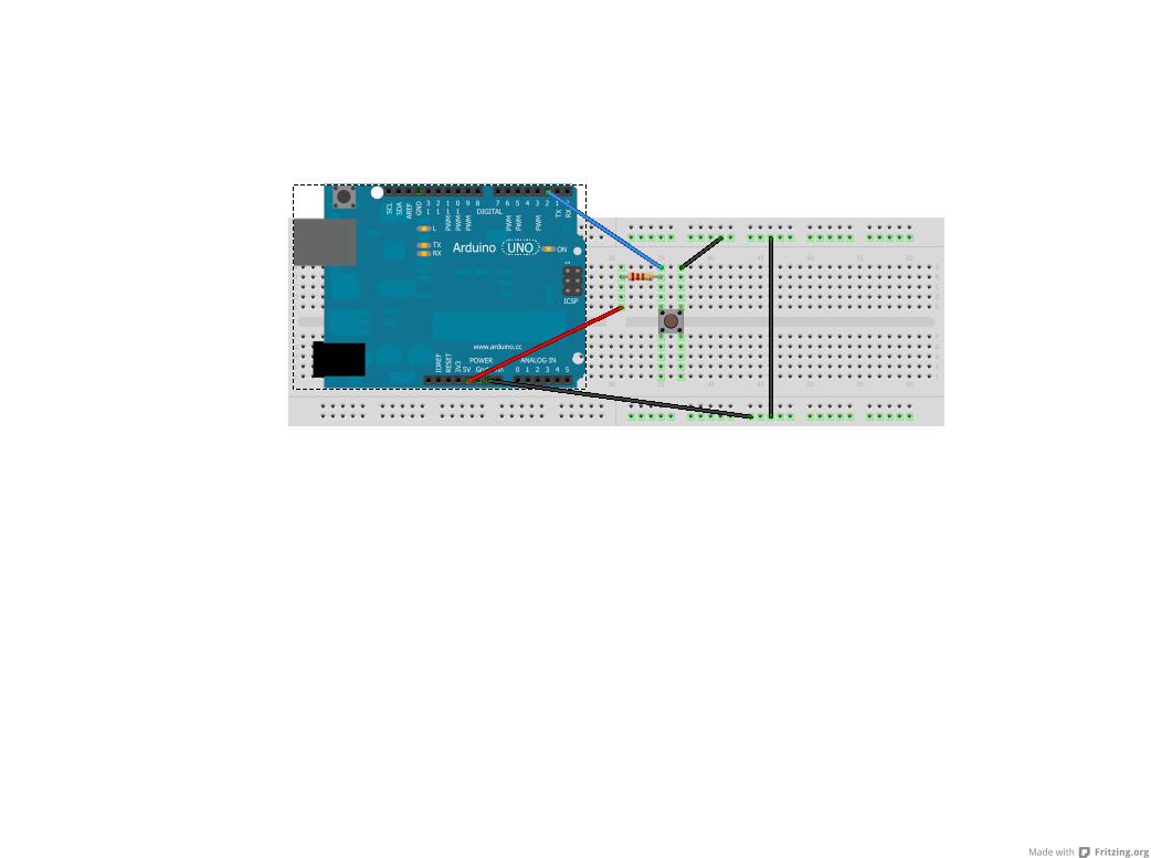

I am having a problem with my Interrupt working randomly. I have pared back the code to just the basics. I have a touch button to Pin 2 (Int 2) (circuit looks like this). When I run the sketch it works as expected, but randomly crashes after varying wake up clicks of the button. Problem is that sometimes it works for 2 'wakes', and other times I get more, but at some pt the sketch always crashes and clicking the button will not wake it up - This can be seen by the serial monitor. I have also confirmed this using just a blinking LED and it also crashes at some random point.

Since when does delay() work inside an interrupt?
madworm:
I've tried changing that delay as well as removing it entirely - so whether it works or not does not play into the issue I am having.
