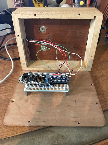

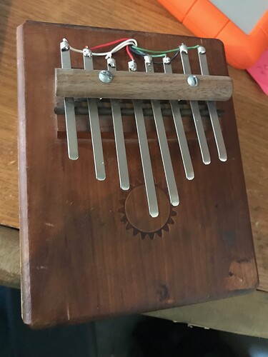

I'm having trouble getting multiple readings from a CAP1188 circuit. I'm building a musical instrument—a mBira, or thumb piano, with an arduino (feather 32u4 to be precise) inside. I soldered directly to each key to turn them into capacitive touch sensors.
Everything works on the hardware side of things, and I was able to get the example code running so that I am able to detect "on/off" switchings for each key independently.
